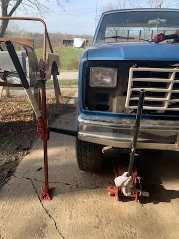

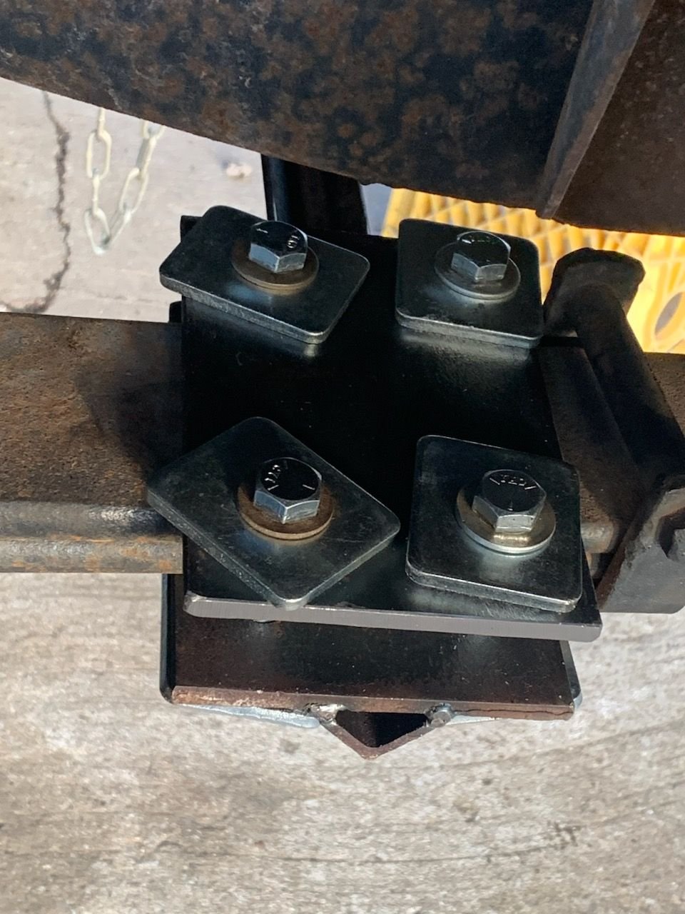

Finally made a tool turns out to be too lightweight. I will try to add a handle to the second plate. Might try to boxing the channel iron handles.
The intention was to use my right foot on the chain to tilt the leaf spring eye so a bolt can be feed through.
The top of the homemade diy ttb leaf spring tilter...... that needs futher Modifications to work as intended. Keep everyone posted.

Hi Garrett,
Yes Agreed. I tried to use it but the channel iron bent when force was applied. So i picked up a 36" long piece of 1"× 1/2" piece of box iron. Hopefully that won't bend. Still have the old design bolted to the truck. Been to cold and wet outside to work on it.
keep you posted on my progress and thanks for your interest.

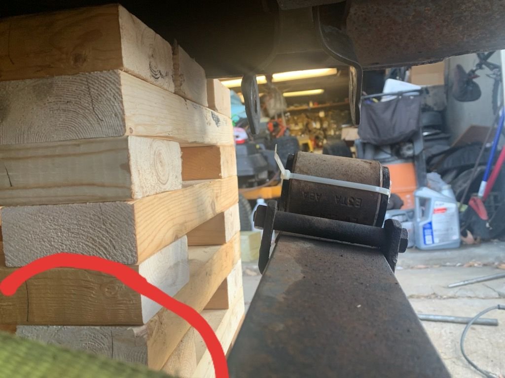

Easter weekend update.
Hi all hope everyone had a good Easter weekend. Well pictures are worth a thousand words.
Hard to see the Bushing but the edge is visible.

Sorry for the delay in a update.
A few weeks ago i had nice weather and some spare time so i gave it another try with ol'blue. (see signature at the bottom of the post)
started with this
This is with the end of the axle lifted slightly and the spring eye shackle at its highest point. Pertty harsh angle.
When i would raise the axle the spring eye Bushing wouldn't come close. From the wheel well.
so decided to use a 3" wide ratcheting strap to try to pull the spring back under the frame.
3" wide ratcheting strap and homemade spring tool
Still with not much change. So with only 4 frosty cold adult beverages down i decided maybe i would sit down to figure out how to pull the pull the forward spring eye in the frame pocket.
An I bolt through the spring eye. Upper center to right.
Lower left homemade Tool Upper right green ratcheting strap going threw the cribbing blocks
Finally
i have started ol'blue (see signature at the bottom of this post) about every 3 months. Amazed how easily it starts every time.
hope to finish the other side on the 4th.

Have you considered putting the shackle in the frame first and then put the spring in last? If you can get the spring higher before it tries to engage the shackle, the higher the springs gets, the closer to the correct spot it will be in.
Old Jun 23, 2023 | 07:52 PM
bullnose1985's Avatar
bullnose1985
Joined: Oct 2013
Posts: 819
Likes: 50
From: North Westren Missouri
Hi Dave,
I did actually at first but with the polly Bushing installed in the shackle and the shackle bolted into the frame there was zero give at all. I looked at the spring eye Bushings and they appear to be softer. Which makes sense for such a small mounting point to have a harder compound.
Well one think so but unfortunately when the spring was raised the angle remained pertty much the same. At one point i had it very close but any higher and it would have shaved off the retention lip off one of the Bushing halfs.
I tried everything that's why it took so longer then a normal. I was beside myself every single time i headed in from working on it.
made a cribbing block i wanted the option to have full droop without wheel being mounted. At one point using two floor jacks and a bottle jack. Still don't know what has caused a 2° + camber originally observed with a metal on metal issue were the rubber had split.
Dave i am going to tell ya that i sure hope it fixes it. With the truck spare tire. Figured after i torque all the bolts i will drive it for a bit to settle the suspension before i re measure. The drivers side front brake caliper was sticking or hanging.
we shall see with everything back together.
