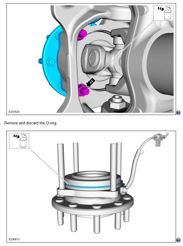

Replacing driver side hub assy on a 2019 F250 super duty 6.2 4WD. Haven’t done a 4wd yet. Is there a special socket I will need?

Comes out by just removing the allen bolts on the face. Once those are loose just wiggle it to get it out, just o-rings holding it then

I'm wondering if he means the wheel bearing assembly?

Have a feeling that is what he is after. In that case, 4 bolts on the back of the knuckle and some snap ring pliers. Im going to assume you already know what else before you expose the bearing assembly needs to come off?

Yup, remove the locking hub and guts. There's a snap ring back there you need to remove. Then, there's 4 bolts on the backside of the wheel hub. That's it

Thank y’all for the info. Yeah I was meaning the wheel bearing assy. Worried I was going to need a speciality tool halfway in. Appreciate the diagrams. Didn’t cross my mind bout there being a o ring on the back side.

You WILL need a substantial snap ring pliers for that snap ring. It is pretty well recessed and it is a stiff ring. Hardware store cheapy wont cut it.

FYI, the oring and studs do not come with the wheel bearings from ford.
