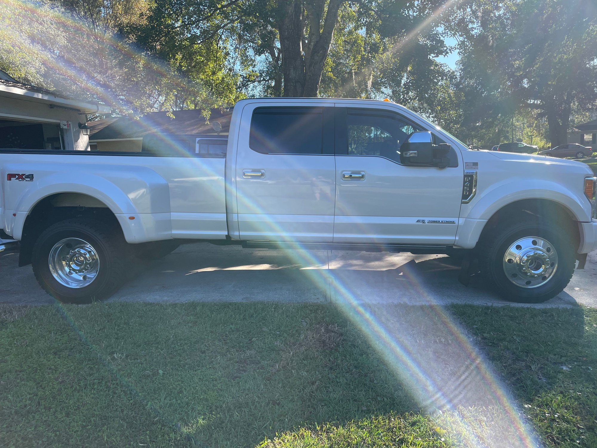

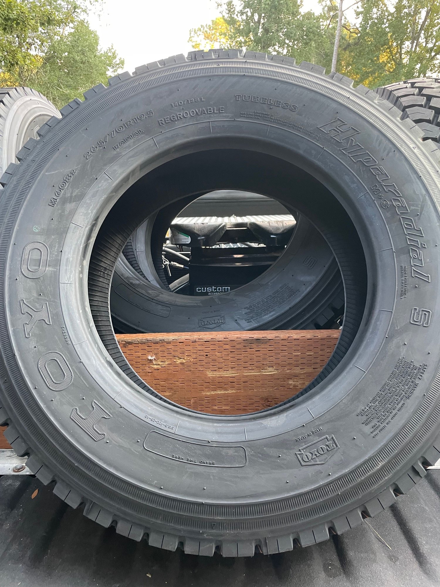

I'm running 265/70/19.5 Toyo M608z's on my 2017 F450 with stock rims. No issues with my tires.

Thank for the 265/70 insight. Thank you for the pictures and the link. Your rig looks great. Did I read you had to install a leveling kit?

Be aware that 19.5 tire manufacturers do not recomend wider than 225s on the factory 6" rims.
I pesonally went to 245 Toyo 608z.
It is difficult to get a flat tread contact with too wide of 19.5 tires.
Not saying you can't or shouldnt , just be aware of the recomendations.
No leveling kit on mine. The other folks put them on theirs.
Can see it in this picture where the edges are untouched.
Kind of looks like the stock front tires on mine with 44K on them, worn on the edges with a hump in the middle.
They look like they have pretty good traction, how are they in snow? No matter what I look at, tires for the 450 are expensive, might as well get the best ones you can.
Old Dec 23, 2022 | 04:58 PM
WK15's Avatar
WK15
Joined: Jan 2012
Posts: 739
Likes: 151
From: USA
No the edges are not touching yet. The tires only have 1500 miles on them. running 75 psi in the rears and 80 psi in the fronts. The fronts are the same way. I would assume that after 5-10K they will flatten out a bit.
