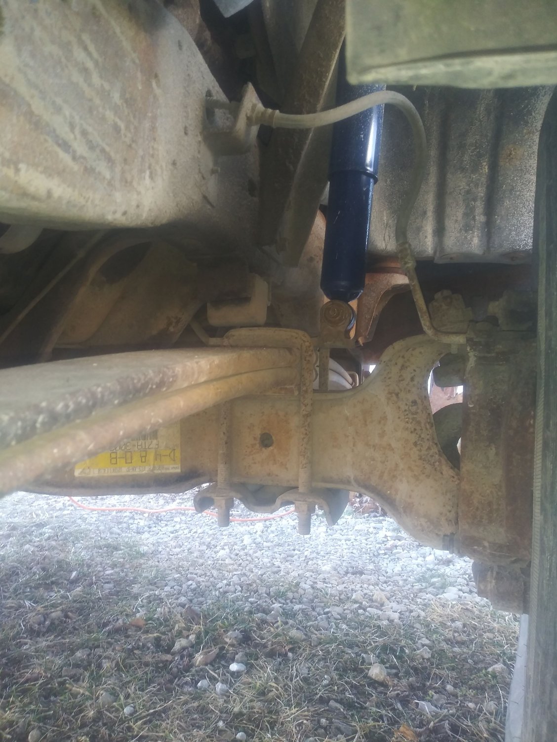

Truck is also pretty rough riding in front also I have new shocks all the way around It sits level but is diesel so is it possible it might need new springs or possibly spring bushings? How much do the springs reflect on ride?

Sits level? It probably has an add a leaf up front. That may be contributing to the rough ride. How many leafs does it have?
No add a leaf and it has 2 leaves is this the way it is supposed to be bowing down the rubber bumper is about a inch from hitting
