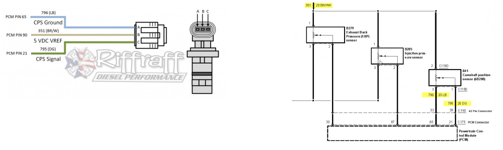

Sure seems like the CPS signal is not getting to the PCM, so the PCM does not command the IPR above 14%. I think that signal passes through the 42 pin connector on the driver's side. Did that harness over the valve cover look ok? Wondering if that's where the CPS wire is broken/shorted. The other check would be to see if you have VREF (5V) on the center pin of the CPS harness with the key on.
From the attached CPS information from Riffraff:
Diagnosis of the CPS is pretty straight forward. Using a diagnostic tool like AutoEnginuity Total Ford Enhanced Bundle [or FORScan] select Engine RPM and watch the readout as you crank the engine over. If you get an RPM reading, your CPS is more than likely working correctly. If you do not get the RPM reading, you need to perform a continuity check on the wiring to ensure you don’t have an open circuit. You can disconnect the PCM plug and use the pins called out in the diagram above to verify continuity. Once you have verified that the wires are not open, you can reconnect the connector to the PCM and verify you get 5 VDC with the key on, engine off on circuit 351. If your wiring checks out, you are pretty safe to say that the CPS has failed and you need to replace it.

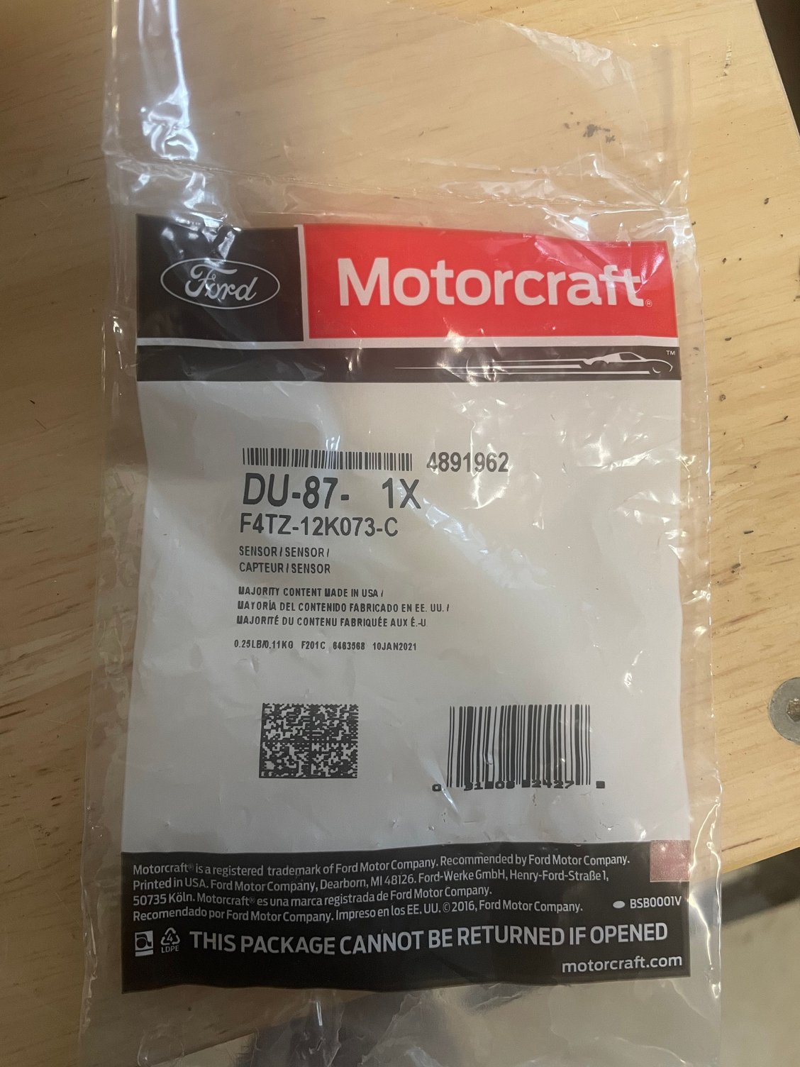

I used a multimeter and put the red probe on the center pin of the CPS connector and the black probe on the ground and got 4.99 Volts . I attached a picture of the packaging the CPS came in. The vendor on eBay (I know this could potentially be the problem) was overstockdirectus which had 100% positive feedback. Could it be a knockoff? Also, could someone direct me to a reputable place to buy a legitimate CPS? Also, is the part # correct for the CPS that I ordered?
Edit: I suppose I should still do continuity test on the CPS signal wire 🤦‍♂️
