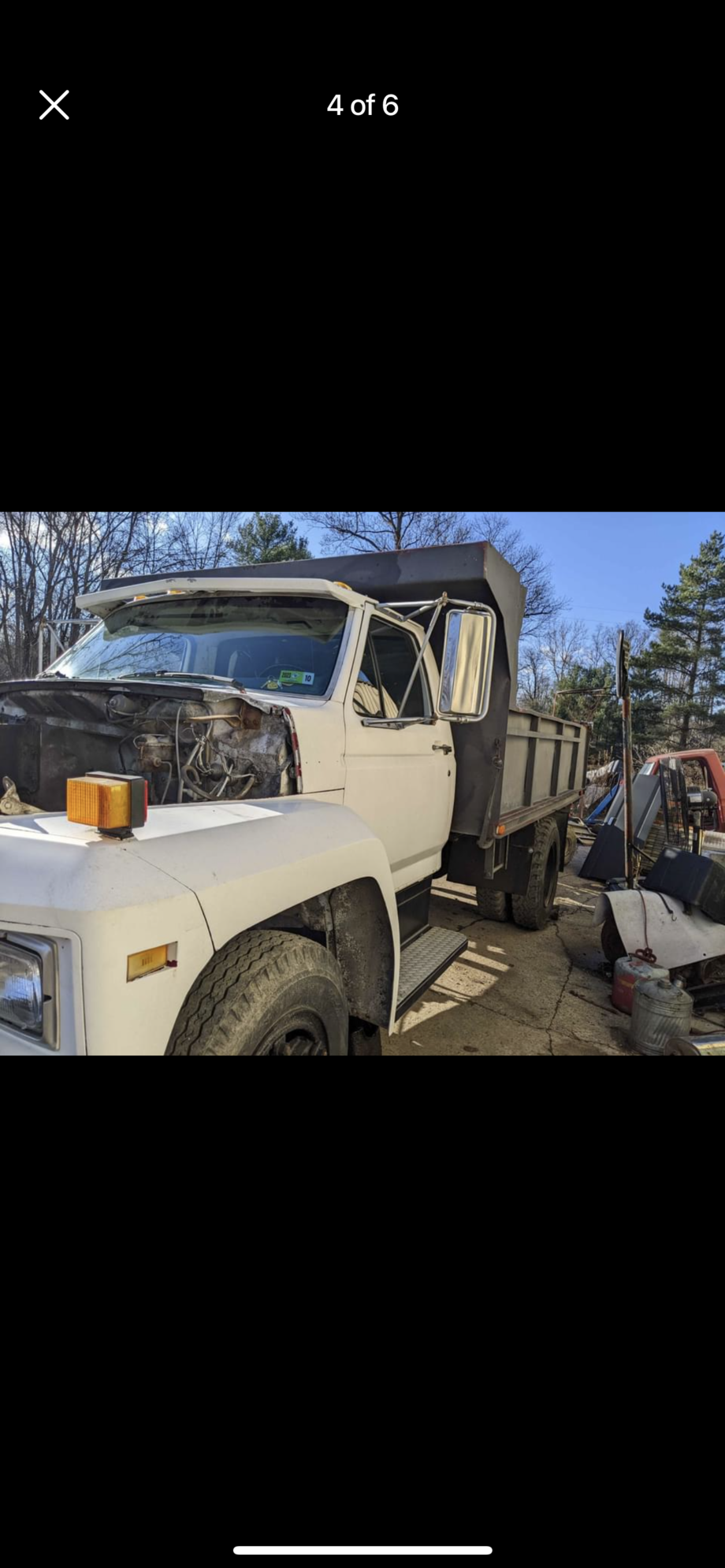

Hi everyone I’m looking at buying an 82 f600 that came factory with a 6.1 370 v8. The engine was over rev and now has a hole in the side of the block. I’m not having luck finding any used engines. Wondering if anyone could point me in the best direction to go with this. Can I make a 460 out of a motor home work? I know the 370 is an industrial engine and had a bigger crank snout. Just not sure if it’s worth buying the truck if I can’t get an engine in it easily.

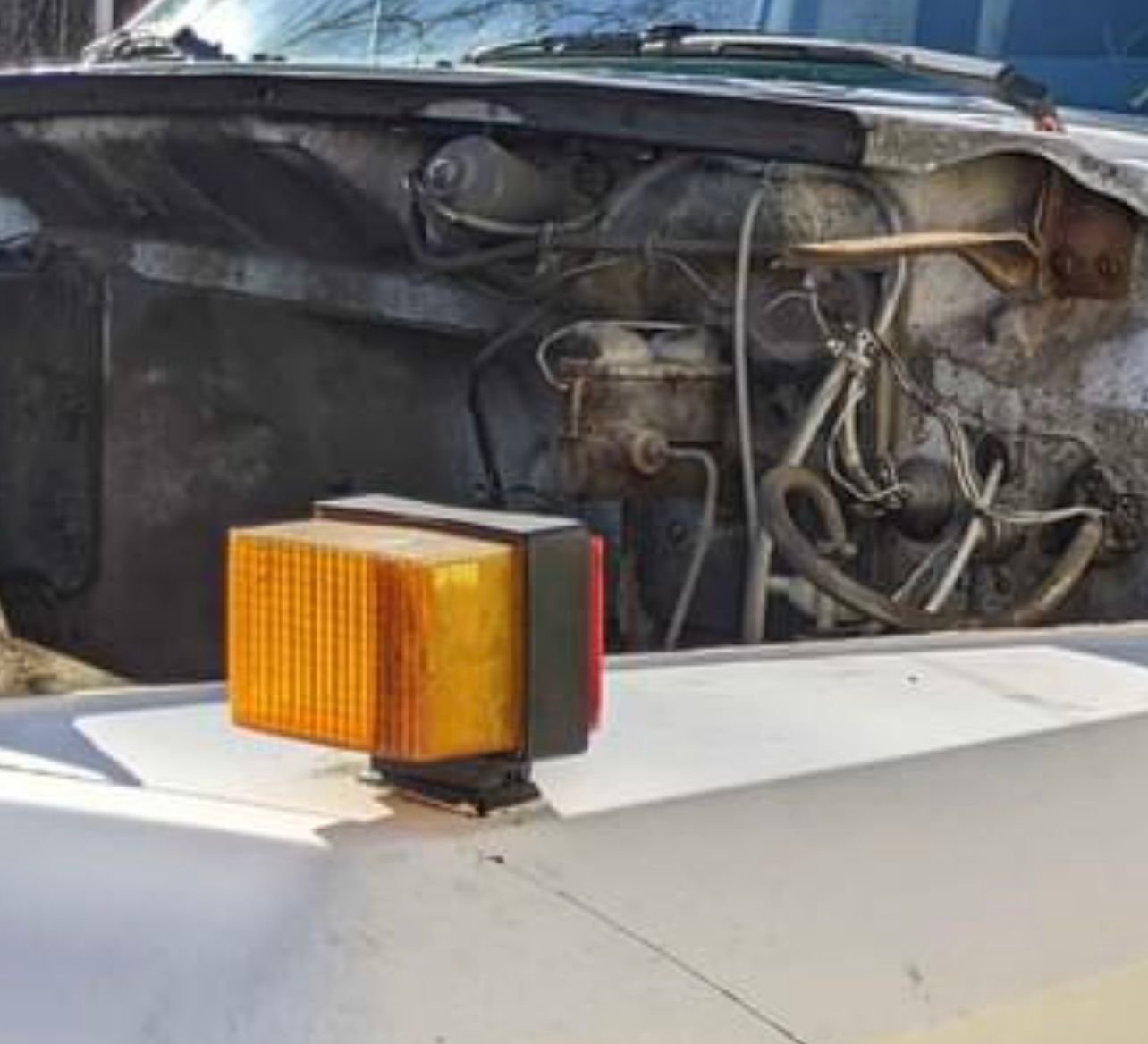

If it has hydraulic, does it have a yellow parking brake **** on the dash? Or a lever on the floor for the parking brake? I'm trying to steer you away from Lucas Girling brakes is the reason for the question.
LG brakes would use a hydraulic pump for power assist, which would look like a power steering pump in most cases.
Vacuum assist would have a vacuum reservoir either on the firewall or under the truck, and if under the truck, a hydro vac booster under the driver seat. These types of brakes are less expensive to service than the LG brakes.

I’m not sure if you can tell anything from the master cylinder or not but this is the best picture I have. I didn’t know much about the truck when I looked at it. I did not notice any fluid dripping around the wheels and the truck has been sitting for weeks since it got towed back. The truck looks the have been taken care of.
