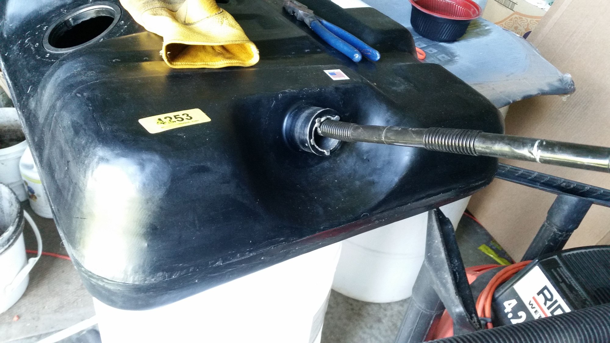

On the tank side of the vent tube it's held by a steel pipe ring. Right at the top of the tank. Stock tank has that holder in the neck. Some tanks don't have that support. The vent tube has a bump out around the tube near the end. That bump out holds the tube up out of the tank.
For my plastic tank I had to fabricate a tube holder:
