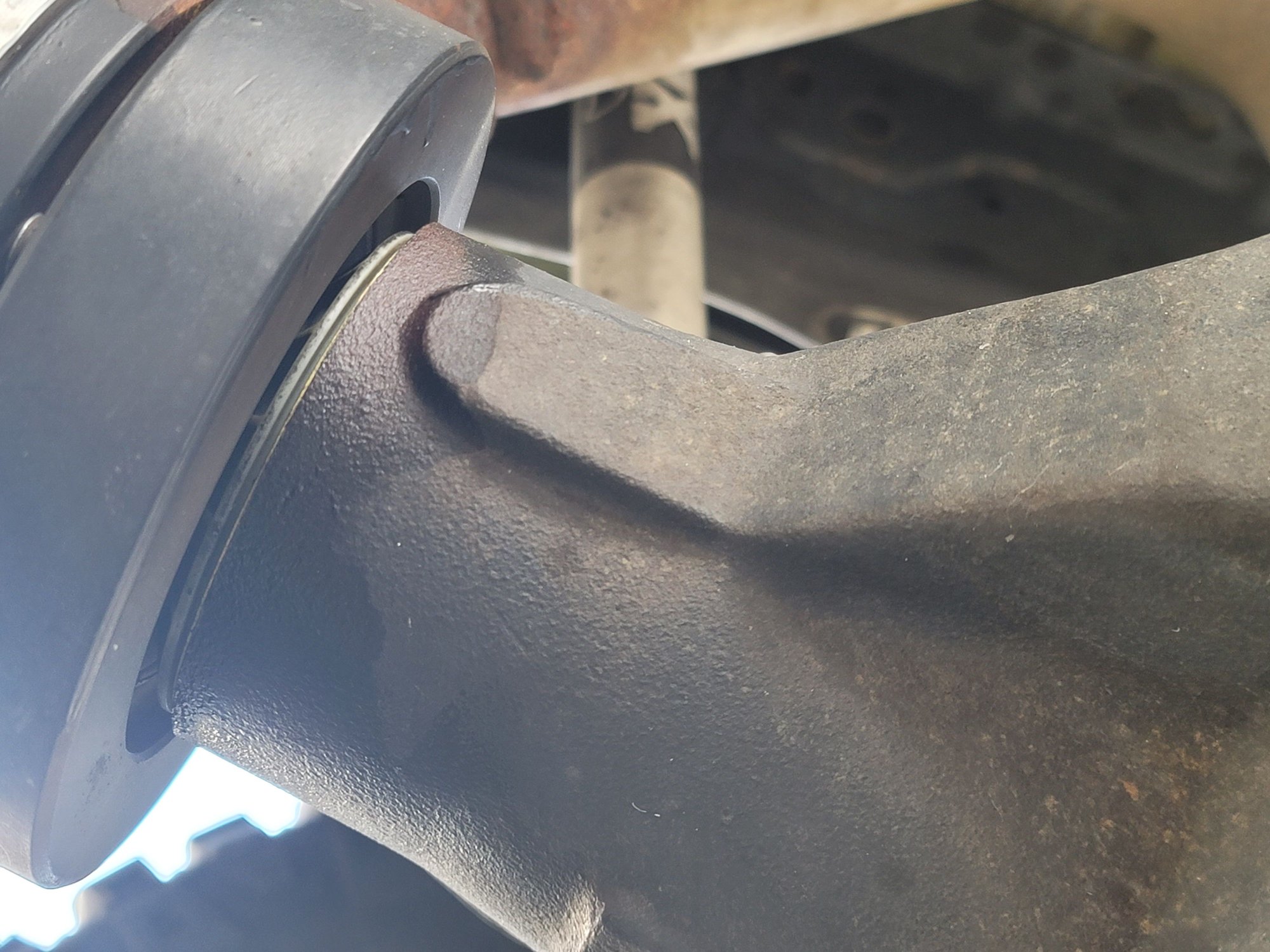

My sound crazy to you guys, but any ideas why it leaked or leaks so soon after swap?
Thing is... It doesn't do it all the time..

I've done many gear installs on the side... reuse the nut.
It could be a bad flange/yoke. If there is any groove in the flange, toss it.
I guess I'm just worried that the damn thing is gonna leak again is all...
You put any silicone on the yoke so the gear oil don't seep past?
I haven't taken it apart this time around... It's just wet. Not dripping... Checked the vent hose too. All clean.. Even ordered a new set up oem for the vent.. All 3 parts.
Overkill I guess. Just don't want it to leak again..
Yes, install the yoke, throw some rtv between the yoke and the threads, and install the washer/nut with red loctite. The rtv helps keep the oil from wicking up between the splines.
Before disassembly, mark the pinion nut in relation to the pinion.. when you tighten the nut, go SLIGHTLY past your mark to ensure that you are setting it up with the same or slightly more preload.
If you're using a new flange or a new nut, the tolerances may be off so the above trick will not work. To do it correctly (if the diff has a crush sleeve) is to remove the carrier to ensure that you have the proper preload.

Did you lube the seal surface or the pinion flange surface before assembling it?
If you put it on a dry clean surface, that can cause the seal to burnish the sealing edge and make it seep.
That wet area on the housing does look like it is just barely seeping, or it could just be excess lube that didn't get cleaned off before you put it back together.

No I didn't do any of that. It's my fault.
Also, I sprayed it all down with brake clean to see how bad it was leaking.. This is how it came back maybe 3 days later. Not spotting, just seeping still
