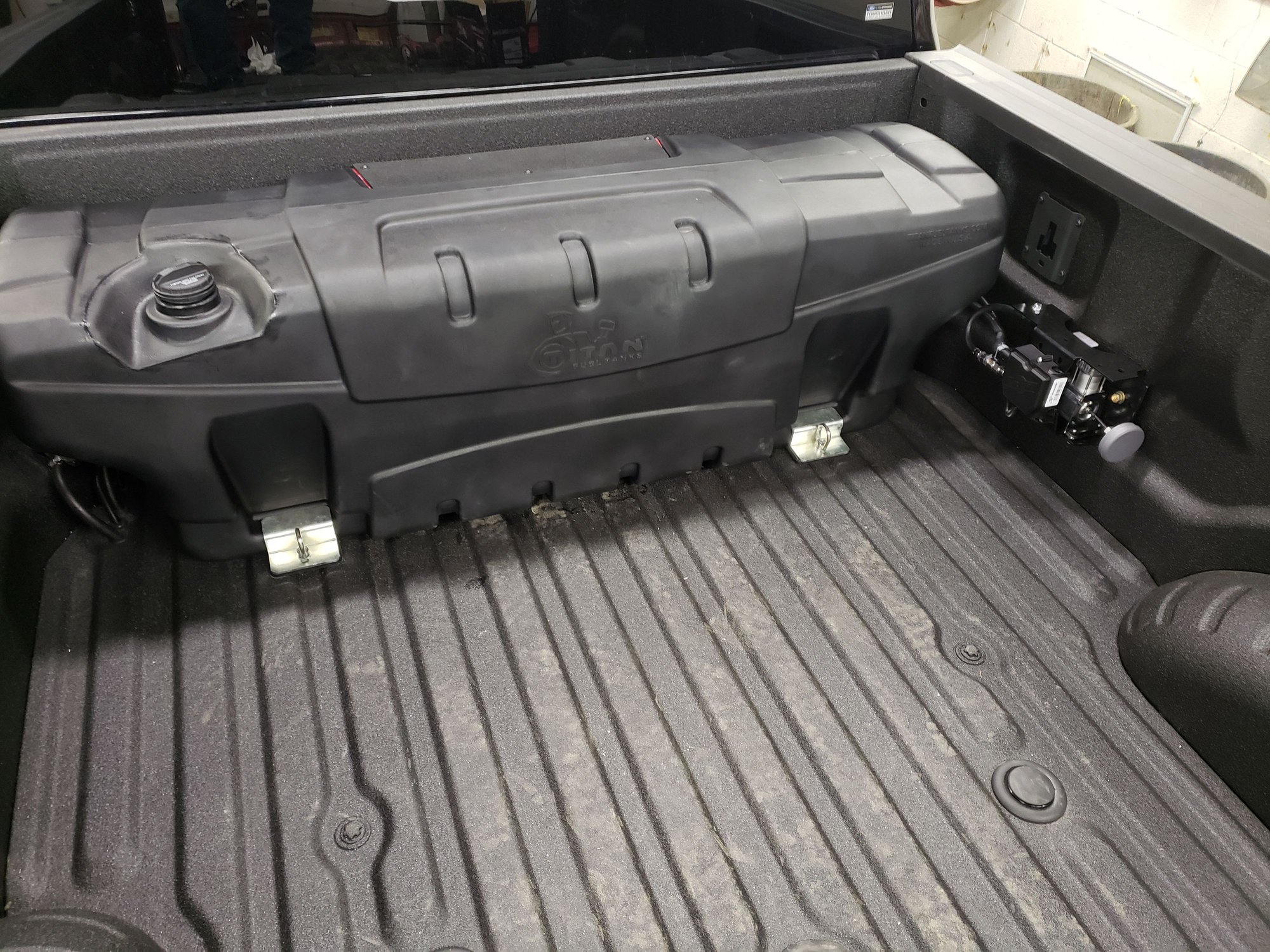

I’m running a Titan travel trekker in my 2022 350 DRW and it holds just under 59 gallons when I fill it up. It’s plumbed into the vent line of the 48 gallon tank from the factory and its controlled with a touchpad in the cab. I’m able to transfer about 5 gallons in a 10 minute pumping cycle while I’m going down the road. These pics are from when I installed it in my 2020 but it’s identical in my 2022. Transfer pump is on the driver side and my airlift wireless compressor is on the passenger side.

Looks sharp - nice work
