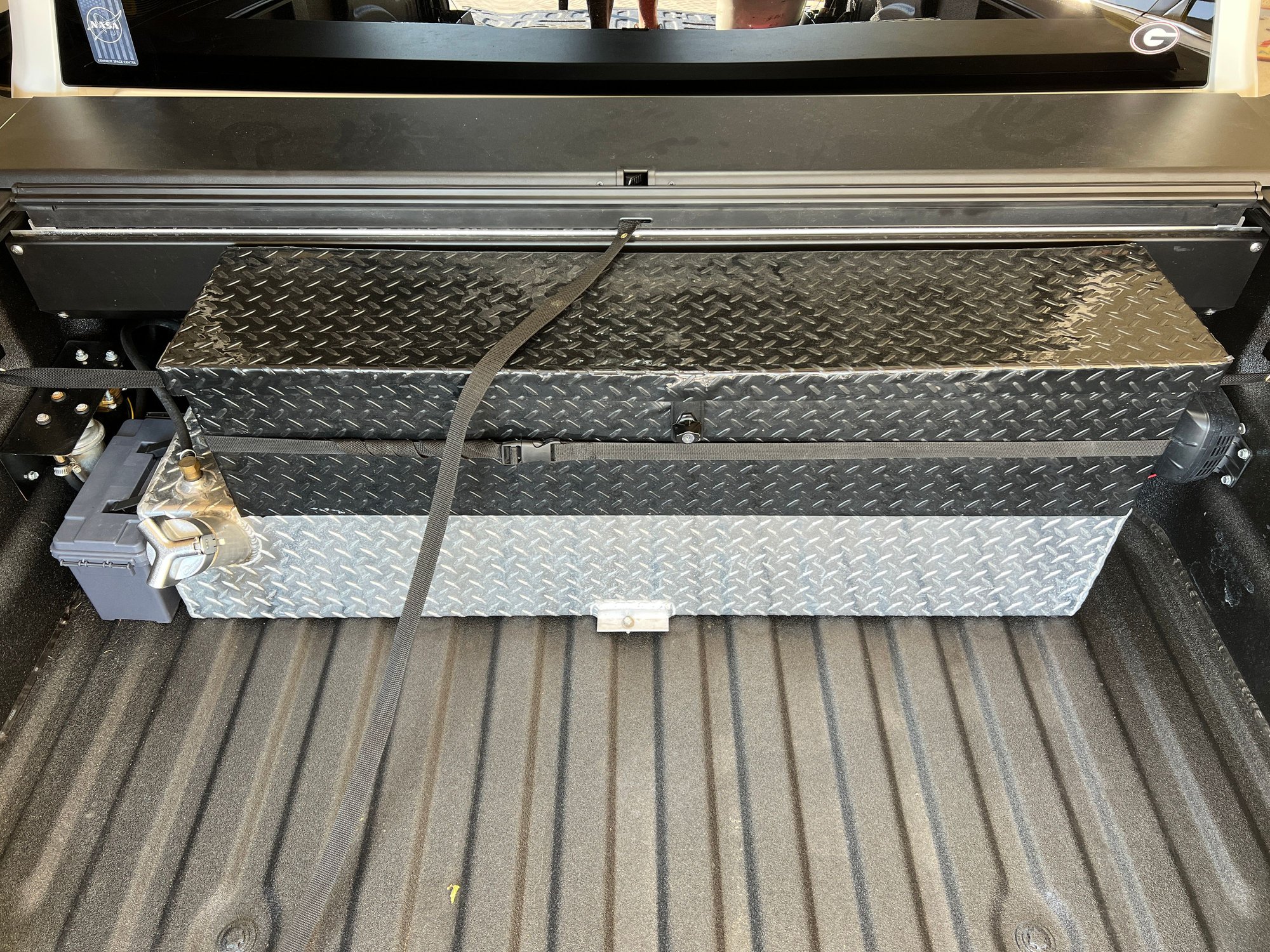

I too believe the 55" tank will fit. But you will need about 57" to 58" of clearance if you want to draw fuel from the lower drain plug area and use a shutoff valve. You could use an elbow at the drain and run it rearward to install a shutoff valve then down to gravity fill, I think someone here did that but it could have been in iRV2 or someplace else.
My RDS tank, when centered, leaves barley enough clearance for a shutoff valve. I think even if you push yours all the way toward the passenger side you may have just enough clearance.
Here is a photo of my RDS 50" wide 33 gallon. That's a custom box I made strapped to the top of the tank; since I have a Roll-n-Lock cover I had to improvise on the box.. On the right is my AirLift compressor. sorry - no good photo of the clearance on the left hand side.
