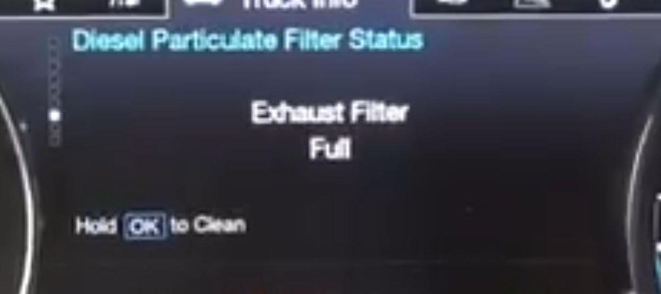

Thanks. Next tine I hit 100% I'll look, but I do not remember seeing a message like that: "exhaust filter full, hold ok to clean". I don't think I have an "exhaust filter status screen".
It's the DPF status screen, same place you view the DPF%. When full (100%), in park, auto regen box unchecked, it should look something like this.

Thank you. I will look next time I hit 100%; probably just me not being very observant.
