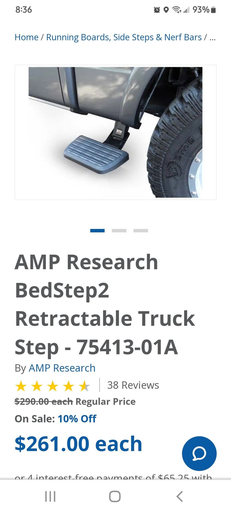

I went with the amp retractable step. Pricy but works well

Thanks for the reply. I actually have those on my 22 F150 and they work great, however given the SDs height and bed length Im looking for something thats more continuous for ease of access throughout

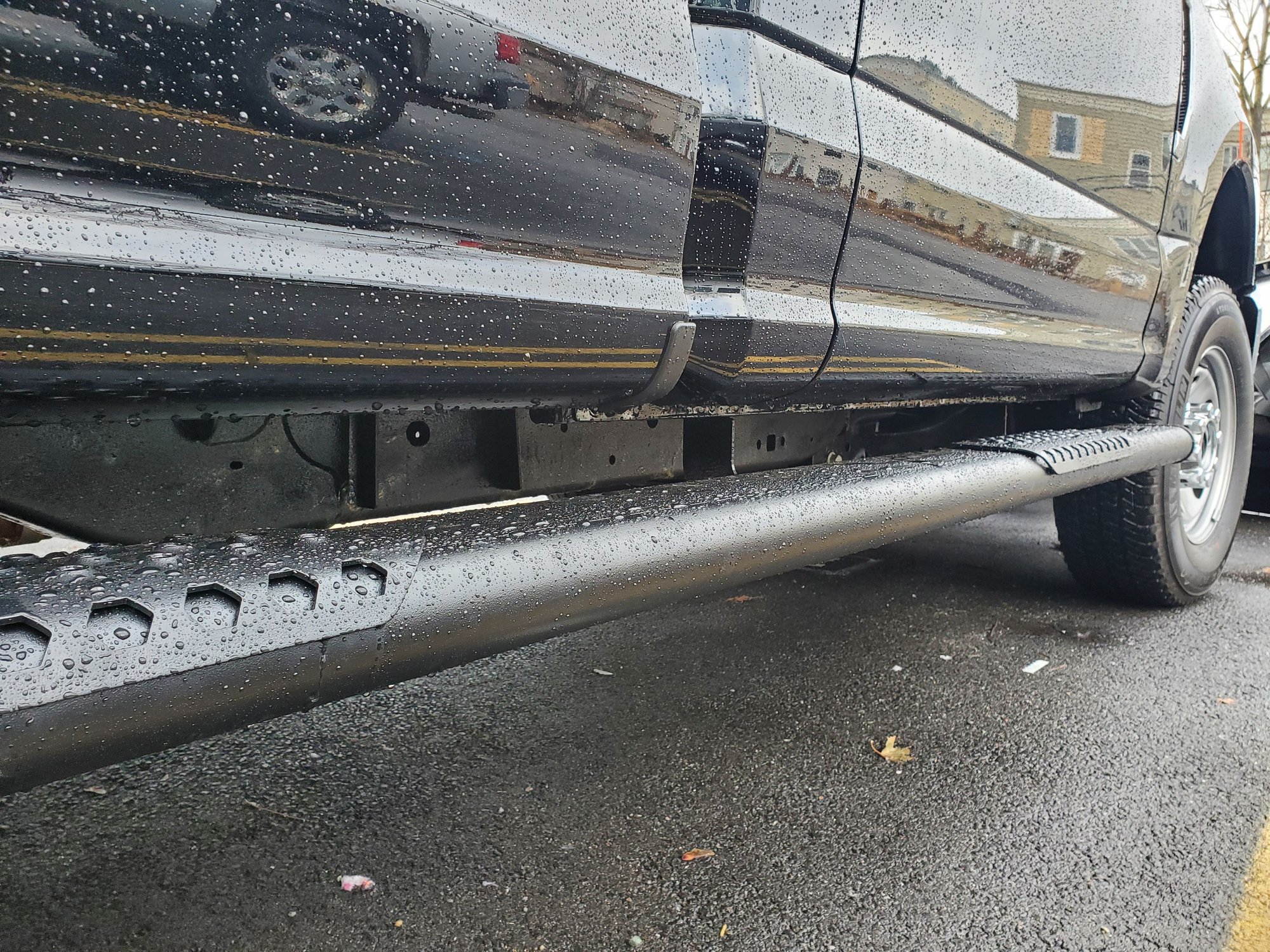

Hi everyone, just wanted to update this thread and report back that the Luverne steps do indeed work on regular cab LBs. Ive attached some photos for reference and will post better ones tomorrow. Some things I would like to point out:
1. They're advertised as "6'' oval boards", but are oval only at the endcaps, other wise they're J-channel type so can be cut for a more custom look
2. The "boards" mount to the brackets by t-bolts and nuts so you can slide them up/down before tightening down.
3. Step pads (6 total in the kit) are in individual pieces and can be mounted anywhere on the board
Hope the info here will help any future/current reg cab owners.
