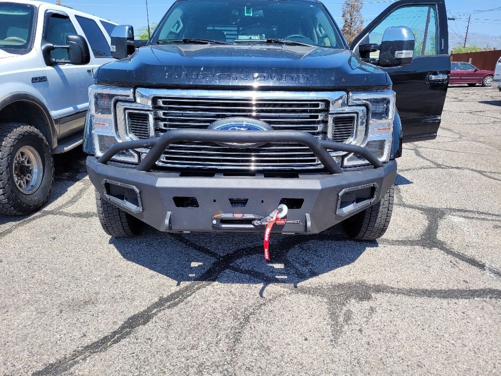

So here's the Harbor Freight Badland Apex 12k winch. They actually make a comparison to the Warn Zeon 12S that you are looking at.
Just bringing this up because maybe you can get a just as good winch for yourself AND save some money...

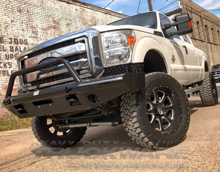

Second, here's a bumper I was looking at for my truck which I think is badass but unfortunately, the plow frame on my truck prevents me from using it because it would not mount up on my truck...
https://www.ford-trucks.com/forums/1...l#post19814971
Direct link to the bumper company website.
Good luck and post up what you go with...
