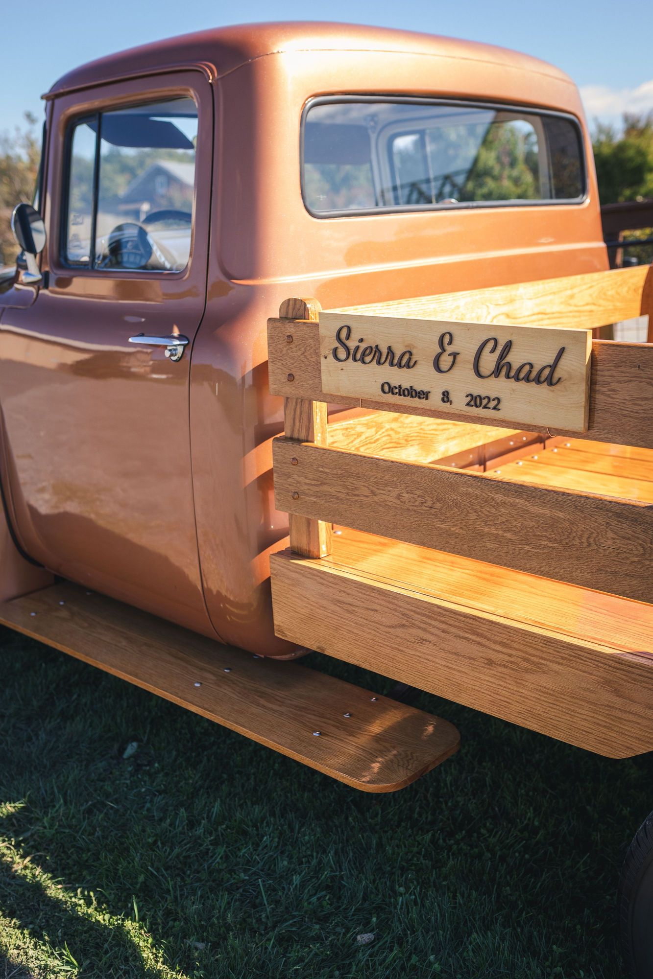

I just completed my 56 with a red oak flatbed. I used deck screws, countersunk holes, mushroom caps glued in and a final coat of marine varnish to seal against water. The deck screws will not stain. My idea was to highlight the wood, not the fasteners. From a short distance, the caps are nearly invisible. If you use, flush caps instead of mushroom, they are even less visible. The downside of this setup is it is not made to be disassembled. Unfortunately, I just had the truck sideswiped on the driver side resulting in wood needing to be replaced. It will be done, but will not be easy. The key to the woodwork is to prevent water infiltration. I even ran epoxy sealer and/or varnish in each hole after they were drilled to make sure the wood is fully sealed.

House hunter, nice 56. And welcome to FTE the best Ford truck forum on the World wide Web..
Are those wooden running boards? Are there ribs in them?

Running boards are 1x12 red oak mounted directly to the original brackets. All wood is red oak with 2 coats of penetrating epoxy and 8 coats of marine varnish. Sunlight is hell on varnish so I went with total boat marine varnish. Will need to lay on a maintenance coat every year or 2 just to keep the gloss and protect from the UV light.
