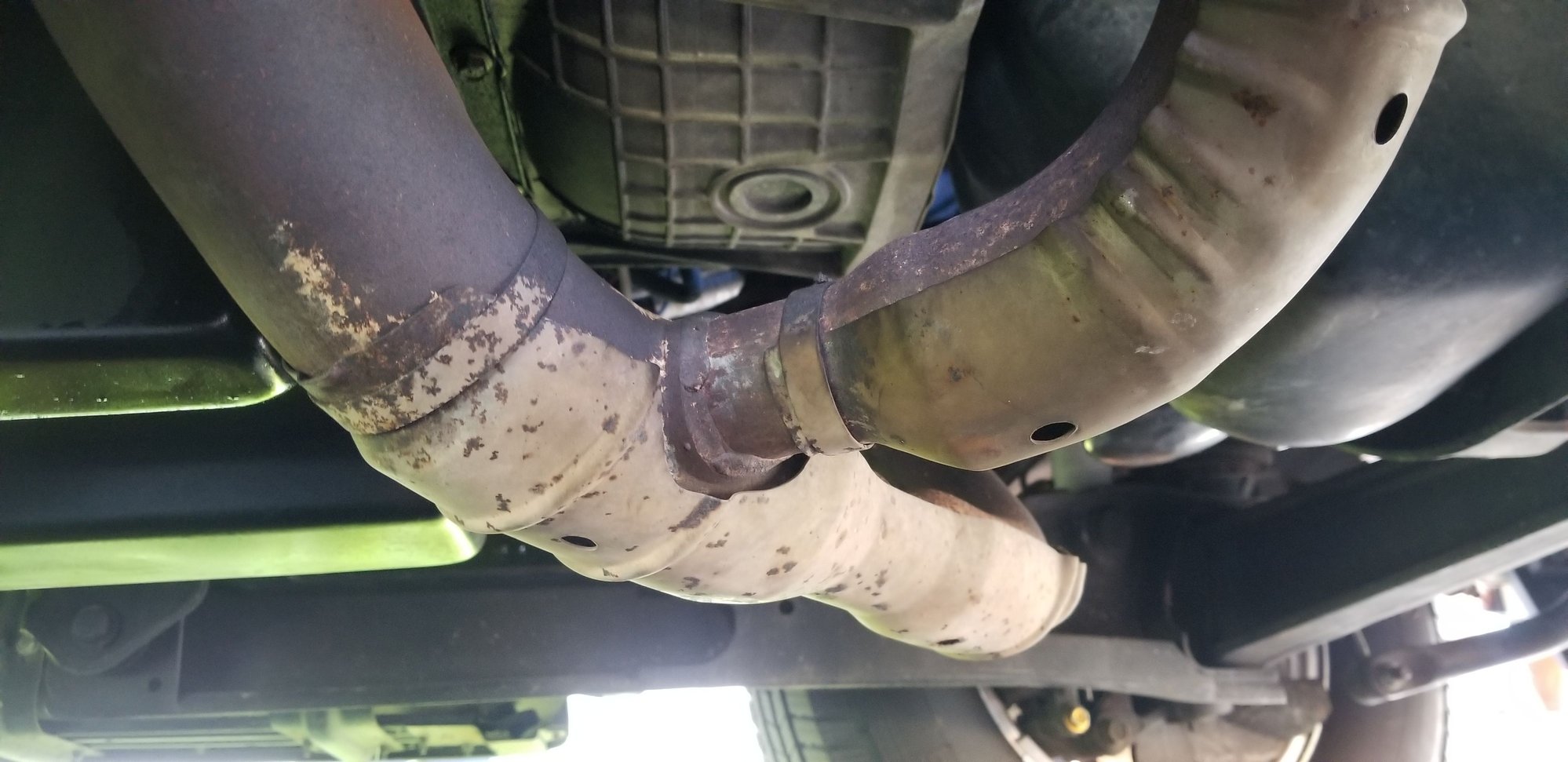

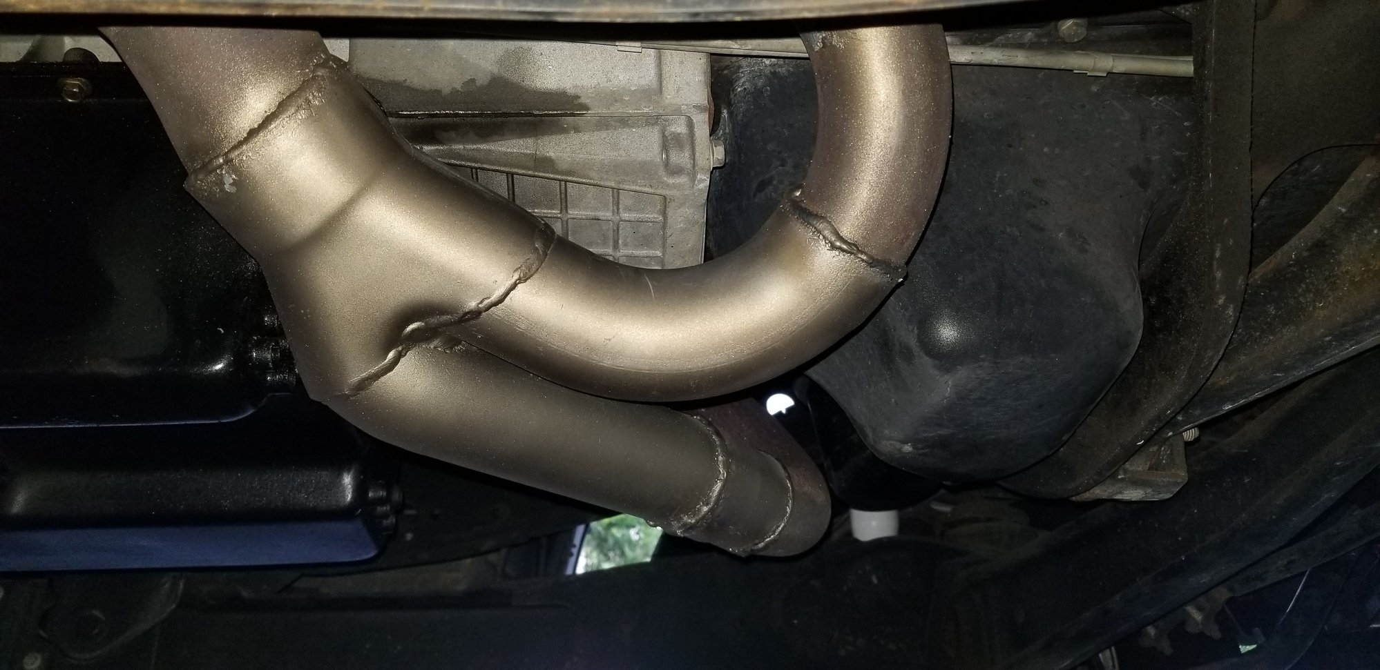

Shortly after the headers, I replaced the restrictive "T" with the "Y" pipe from 5 Star Tuning and then got a set of tunes with those two additions. Did it make a difference? Honestly, nothing that I could tell from the driver's seat other than a little more cabin noise. I am hoping that there is/was a slight improvement when towing my 9k trailer up the grade as I head up into the Smokies.
shorties are a proven zero gain
