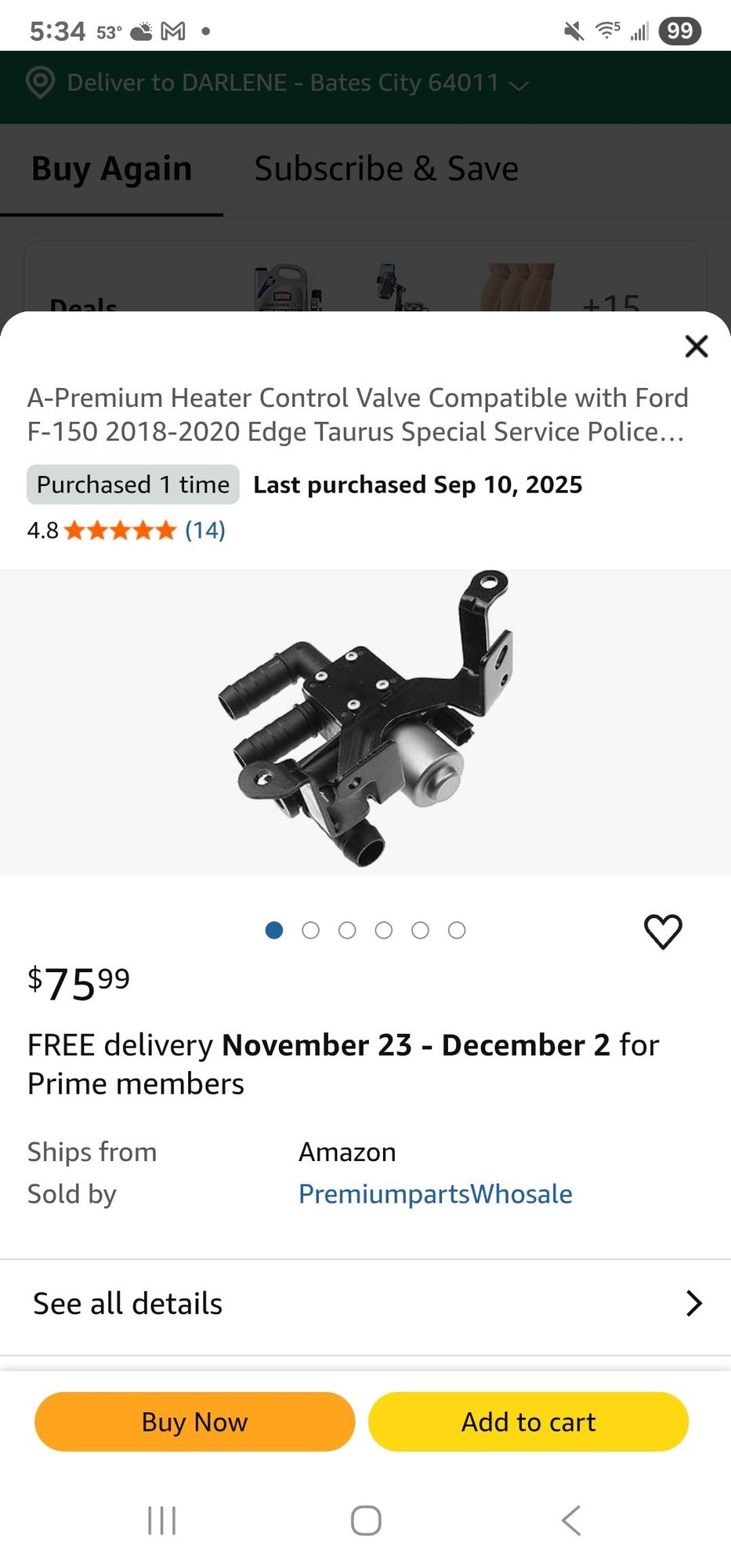

Here's the part I ordered from amazon
Originally Posted by stone36441
Do you have a link for the hvac module? I have a 2019 f150 5.0 that recently started doing the same thing. Only gets luke warm at best until heavy acceleration. I have tried topping of with coolant and burping the system but so far no luck.
Heres the part i ordered from Amazon, you can also find videos on replacing it online its located in the passenger side wheelwell.
Heres the part i ordered from Amazon, you can also find videos on replacing it online its located in the passenger side wheelwell. You'll have to change the mounting bracket. But other than that it's identical.
Good luck!

Thanks I'm gonna start with the heater control valve but I was curious as to why this would be the reason the return hose from the heater core would only be warm as the inlet hose to the heater core is alot hotter? Apreciate alll your help.
