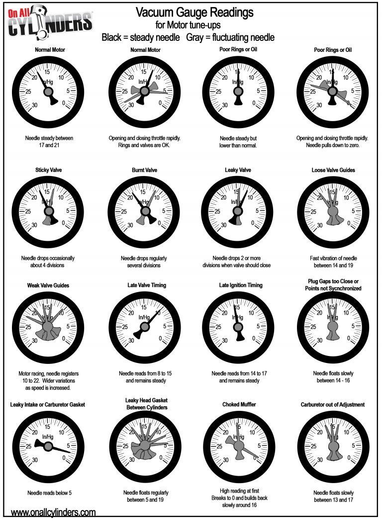

SO, The vacuum needle is bouncing like there's a misfiring cylinder, manifold vacuum is low (10inHg), and I'm having to adjust the idle mixture way out (closing to less than 2 turns makes it run badly). That all points to a bad vacuum leak. But I don't see one, other than a small leak at the throttle shaft. Could there be a leak between an intake runner and the valley? I'm about to throw an aluminum intake and Edelbrock 650 on it.
