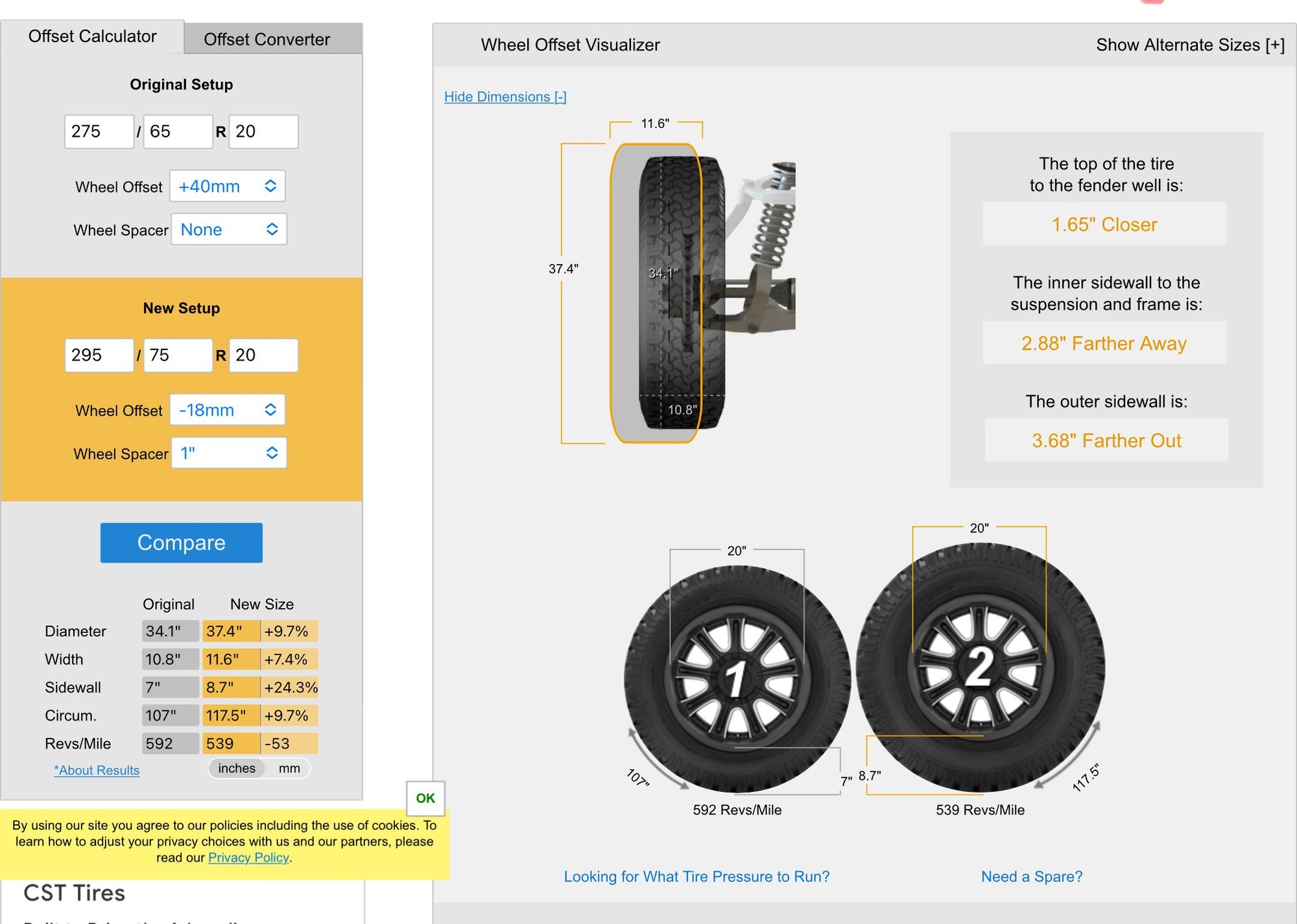

Always kept the stock wheels but since the 23 Platinum wheels are hideous I’ll be swapping them out. Looking at method 304 item MR30421087318N. Will these be “like” stock, meaning won’t stick out the side a lot?
Plan on just doing Toyo AT3 37x12.5x20. I current have Toyo MT 35x12.50x20. Surprisingly the AT3 weigh much less even though it’s a 37”v35”.
  • Wheel Diameter (IN)20
  • Wheel Width10.0
  • Bolt Pattern8x170
  • Offset (mm)-18
  • Hub Bore (mm)130.81
  • Backside Spacing (in)4.76
  • Wheel Weight (LBS)37.2
  • Max Load (LBS)3640

Have a link to the site you posted screen shots of?
Disregard: https://tiresize.com/wheel-offset-calculator/
