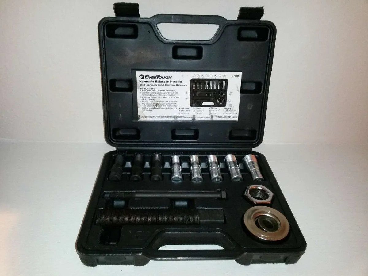

I am installing a Melling lpop and a new balancer. I see its required to put ford style sealant on the keyway. How do you do that? Do seat the balancer and then put the sealant on? I'm going to rent a balancer installer tool from my local parts store. I noticed there was sealant on my washer and bolt when I took it off. Getting close to putting her back.

Just add a small dab of sealant in the HB key way slot.

be sure to pull bolt remove washer and reinstall bolt before installing puller. Prevent thread damage

Already have the new balancer on. I used the installer from O’Reilly Auto Parts. I torched out a plate to push against because our balancer is recessed and there is no way to turn the nut.
