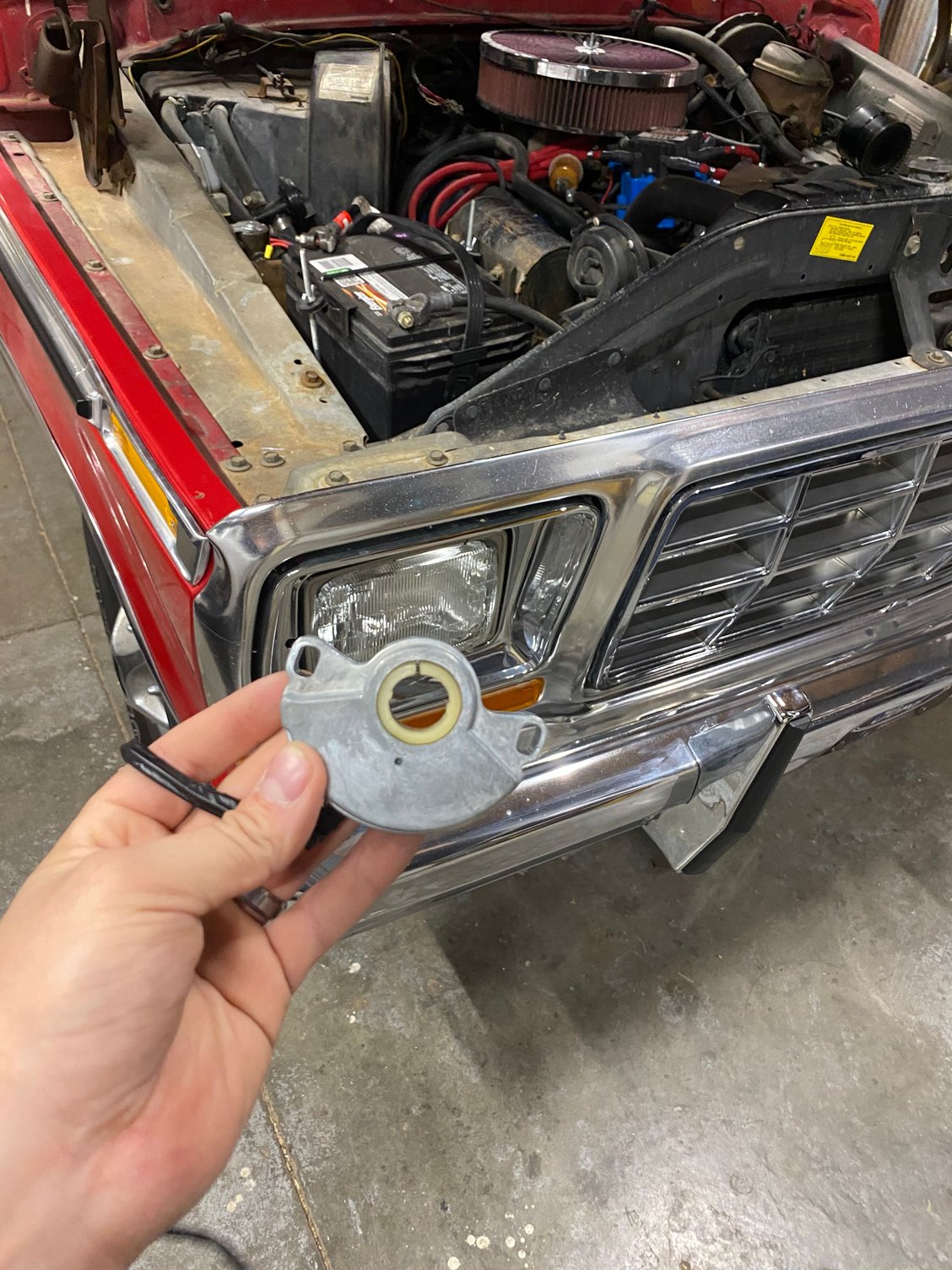

1978 neutral safety switch replacement. If you are like me, you run into the same problem. You keep seeing videos that show you a neutral safety switch that is located on the steering column. That being said, it is very easy to replace this. Mine is a C6 automatic transmission. The switch is located on the driver side of the transmission. Remove one 1/2” nut and washer. Then slide off the arm or “bar”. Then remove the two 3/8” bolts or screws that hold the safety switch in place. Slide off the safety switch. This may take some elbow grease. Then you’re done. Replace with the new part and plug in your harness.

Update. Success! Sort of. I took the switch off so I could shine a light in the hole and used some pliers to rotate the inside part until I could see the hole. At that point I inserted and small nail and taped it in place. I then installed the switch back on the transmission. I had to put the truck in drive so it all lined up. After I installed still no lights but the truck wouldn’t start in neutral. Pulled it back off and did it again. This time it started in park and neutral and the back up light flashed on for a second. I had my wife move the shifter back and forth and there was a spot where the lights worked but went out when it was fully in reverse. Loosened the 2 bolts and rotated left a bit more and they work in reverse now. Well one side does. Now I have back up on the driver but not on the pass. Switched bulbs. Same thing. In reverse I tested and get 12 volts in the socket. But still no light. Looks good inside but the bulb must not be making connection somewhere. Done for the day so I’ll mess with it later but it should be easy from here. Thanks all!!! Really excited to have back up lights.

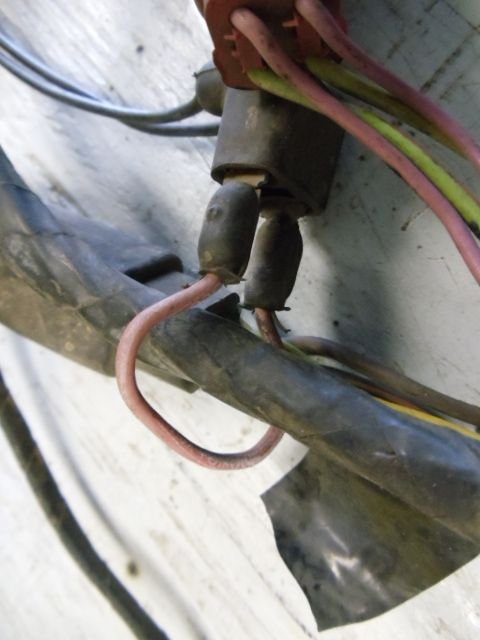

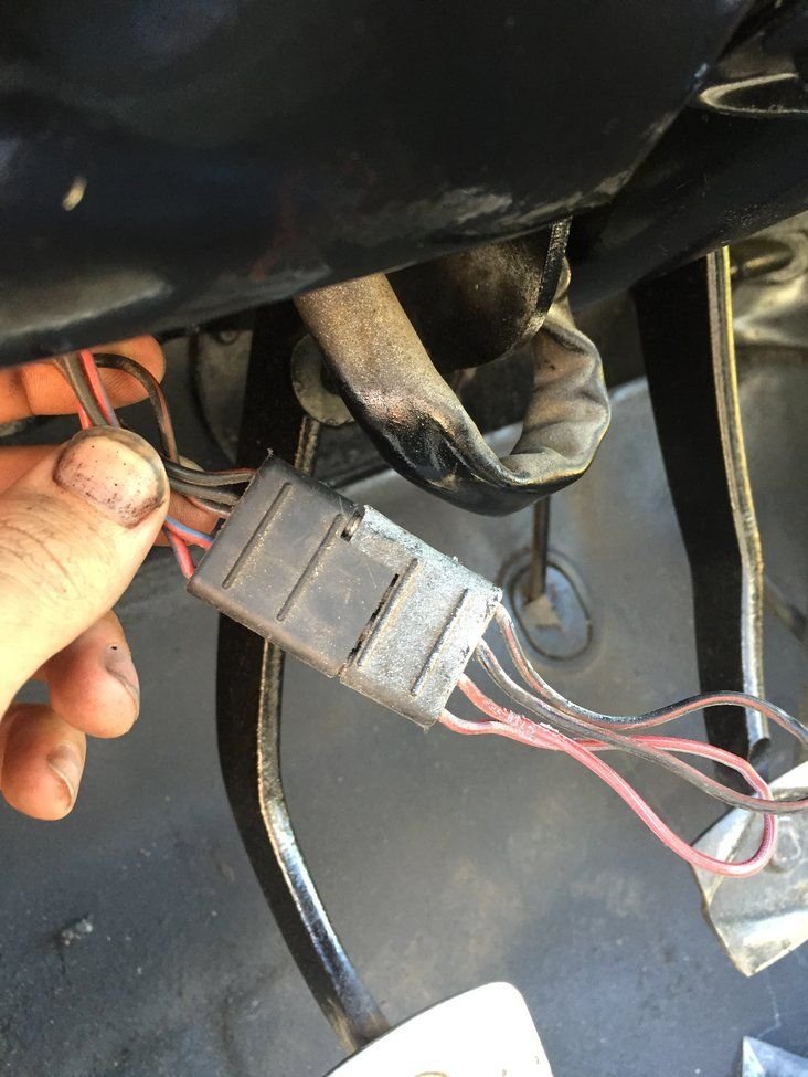

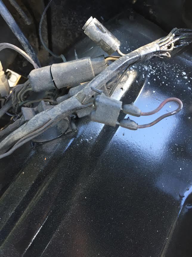

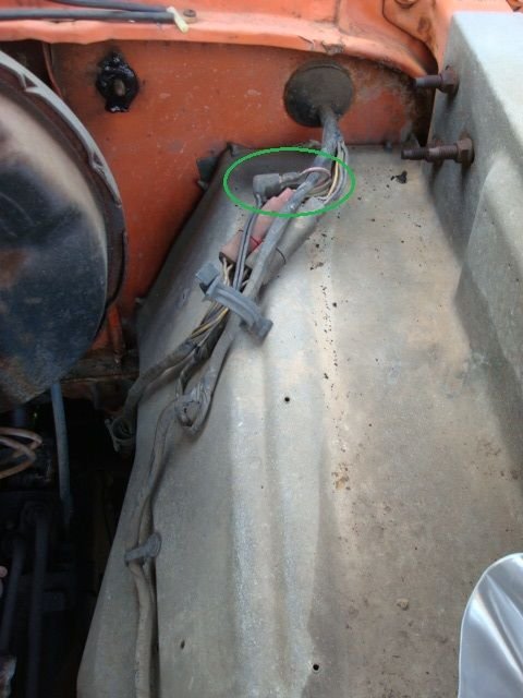

"When the trucks came with a manual trans, there was a dummy plug used to bypass the NSS switch. I've never been able to come up with a part number for the dummy plug. To bypass the automatic set up: Unplug the switch and discard or ignore. There are four wires in the harness plug, two each, red w/ blue trace and black w/ red trace. Run a jumper between the red/blue and red/blue, do the same for the black/red. That completely bypasses the NSS switch. Your truck will now start and the back-up lights will be permanently on. Now on to the backup lights.In the engine compartment is a little U shaped jumper wire. It'll be located on the drivers side splash pan, just in front of the firewall where the wiring harness comes through. Unplug the little jumper, this will shut off the back up lights. There should be a back up light switch on the trans cover. Run two wires from the switch to the two wires that were jumped. This will get your back up lights working again. Just a note, you could make a jumper plug out of the NSS. Cut the switch off the harness and splice the two pairs of wires. I just hate to cut these switches up. New, they're getting pricey. Here's the little jumper in the engine compartment. EDIT: If you don't care about the back up lights, just jumper the red w/ blue trace wires. This will by pass the NSS but the back up lights won't work."
Pretty sure manual trans NSS by pass and reverse lights plug.
Engine compartment jumper?
