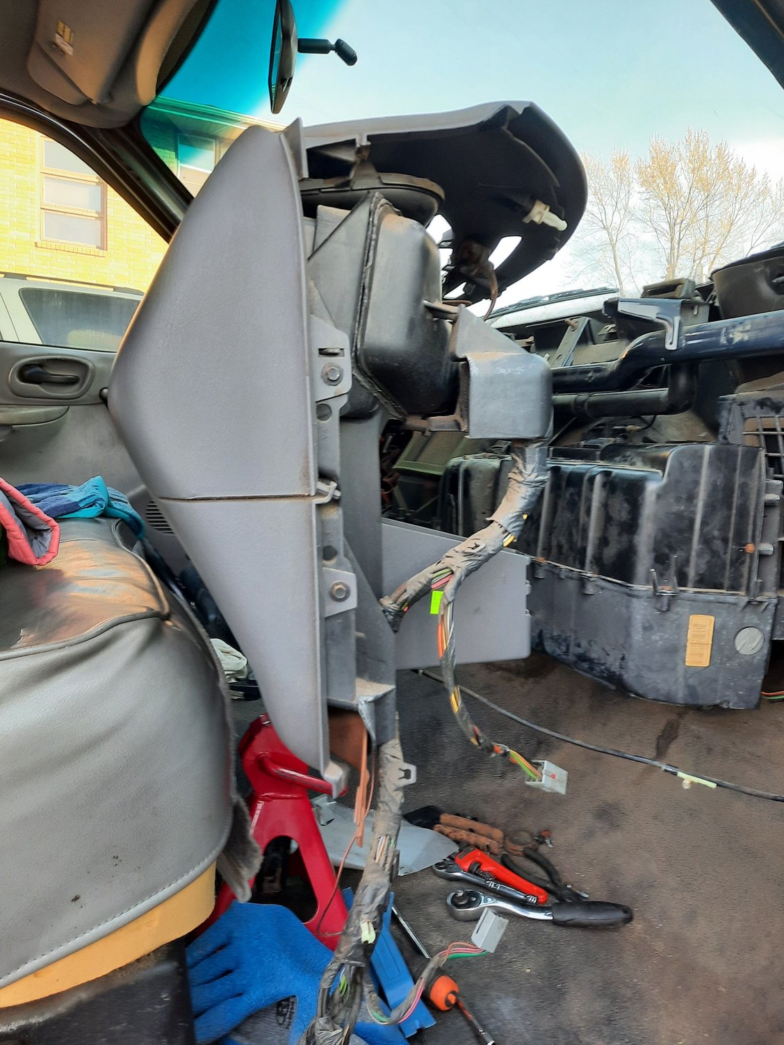

Project is done. I did it second time. First was in 2010. Used same directions as before. I think it is sticked here on forum. As I did cut heater hoses before to make bypass, I had to use Dorman adapters https://www.autozone.com/cooling-hea...E&gclsrc=aw.ds
Didn't have much capability to swing dash. It went so far as in picture. But it was enough to have space to pull out the heater core. I do not understand why everyone talks about cutting heater pipes. I just broke plastic wings of quick connectors and pulled core out without any problem.

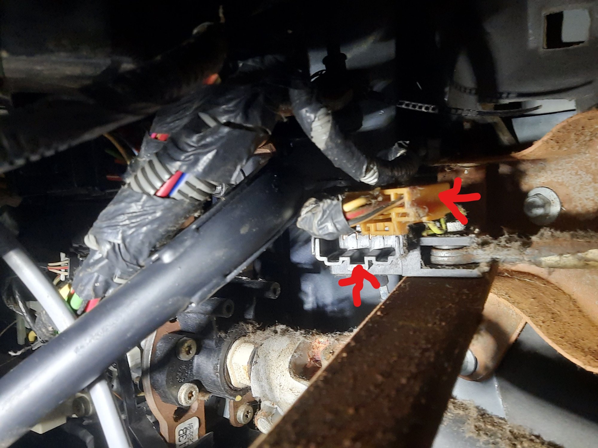

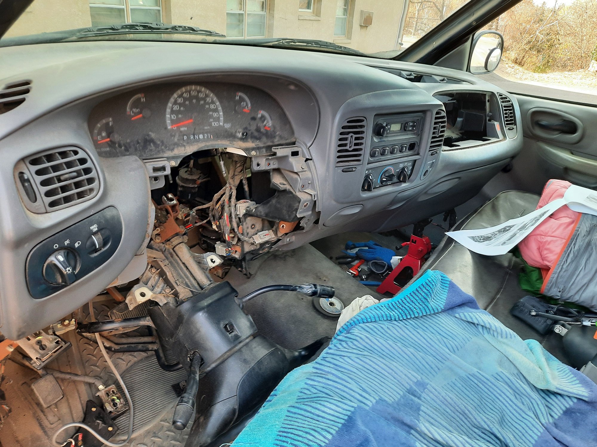

One more photo. Steering wheel need to go all way down to move dash.

One month later the brake switch connector that is below steering disconnected itself. No big deal just if you drop steering wheel double check every connector that is below it when putting things back.
