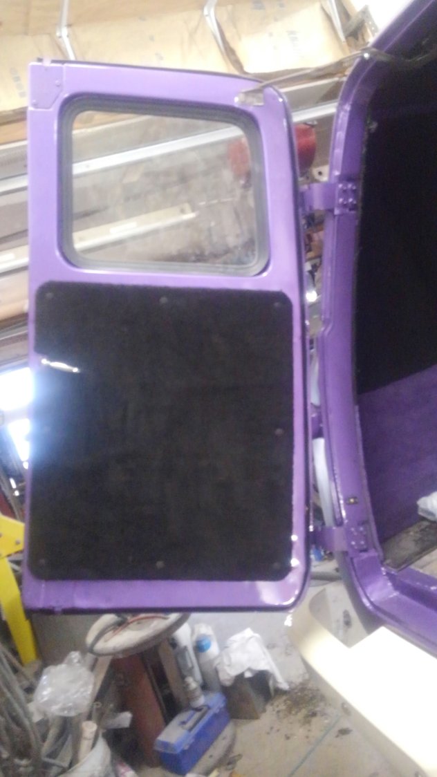

Hello, How much paint will it take to paint a 60 panel truck ? I have the doors and jams all done. I am using nason ful-thane 2K urethane single stage. Plan on using clear for the finale coat. No hurry on the answers. It will be this spring or early summer. Thanks All.

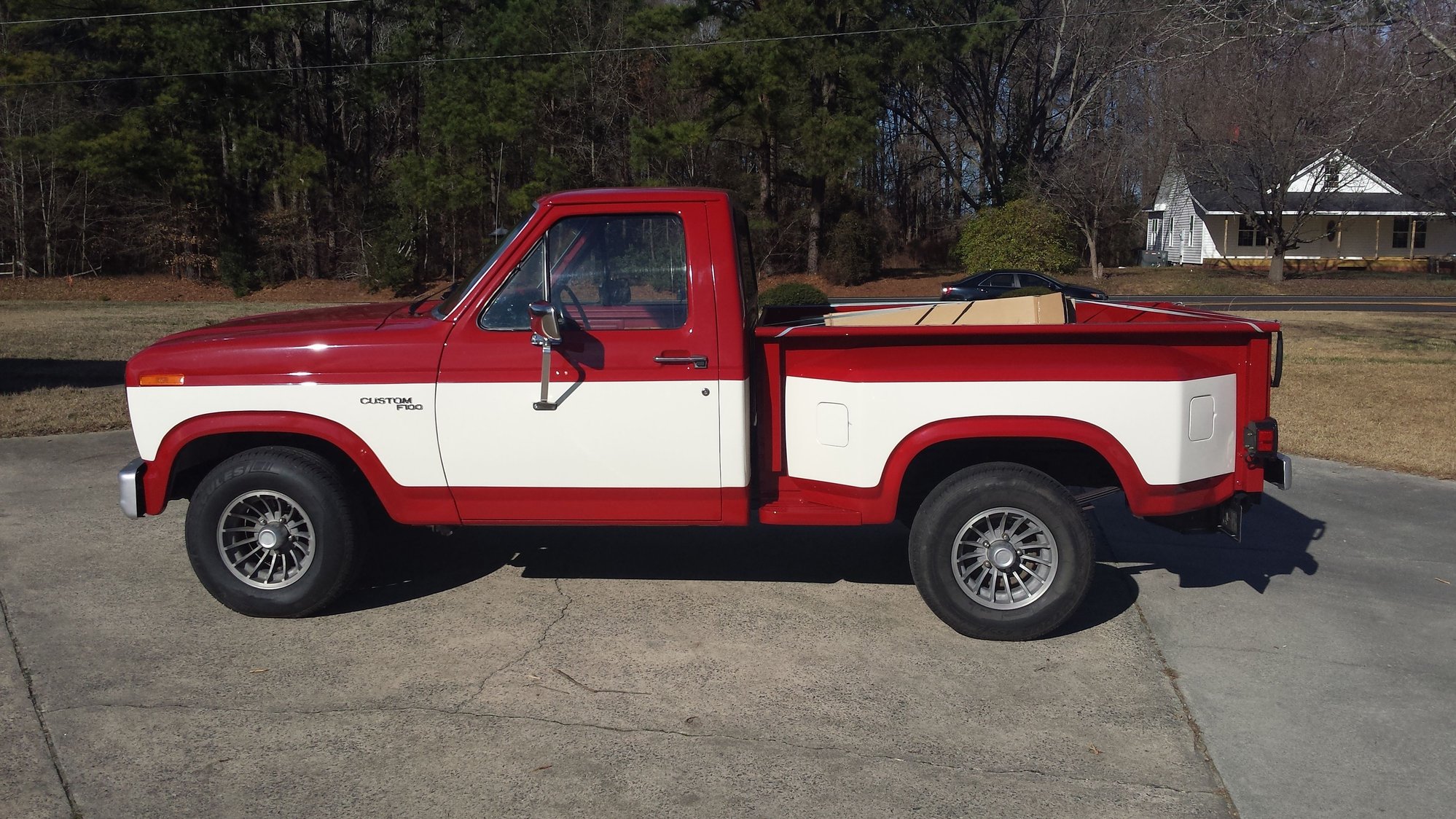

A lot has to do with how well the paint covers.
My factory Candy Apple red had a lot of clear and took at least 3 coats just to cover and get an even color.
Mine was also a single stage, so if I was going to cut & buff I would have to put at least 3 to 4 more coats.
Think I did 4 coats, no cut & buff with this single stage, and it took almost a full gallon and I had white down each side.
BTW if you are doing single stage why the clear top coat?
The white covered pretty good
Dave ----

Very nice truck and love the color. They go great together. Last time I painted was ragoon red with acrylic enamel 30 years ago. This new paint is a big learning curve for me. I used nason single stage for bumpers and rims. Just did jams with ful-thane 2K urethane topcoat. This spring I will paint the truck. New paint products and new devilbiss spray gun, completely different to get used too.

Thanks on the truck and they are the factory colors it had when it left the plant.
I used NAPA paint forget what their low dollar paint line is called but I was happy with it.
Only thing I did ask for because it was hot in my garage, not a professional spray booth that you can control the temperature, was high temperature reducer.
They never heard of such a thing and in checking found it so that is what I used.
The high temp reducer slows down the drying and let's the paint flow out so less orange peel if any.
I also was using a new to me HVLP gun, Eastwood Start line 3 gun kit.
Other than using the small gun for inside the cab, door jambs and under side of hood i had naver used a HVLP gun before.
I changed over the small gun to use the large cup so all 3 are large cup guns, 1 gun is a primer gun I have not used as I used and old Binks #7 gun for primer.
I also use the Kcups for easy clean up.
no paint is in the cup it gose in a plastic liner that fits the cups then a lid. Throw the liner away, little reducer thru the gun head and done.
I feel the start line guns are a good spray gun and people ask who did the paint job and if 2 stage.
They are shock when i say i did it, single stage and no sanding & buffing.
Take your time and it will turn out great.
Dave ----
