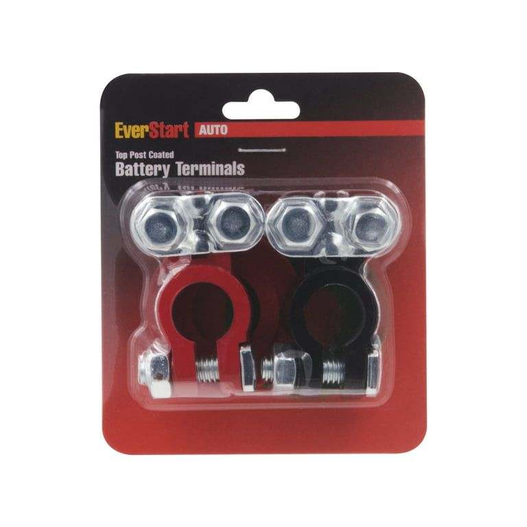

It used to slow start, but I replaced the positive and negative battery terminals and it seems to start normal. That is when it wants to start.
Btw it's just some basic Walmart terminals, but it was better.

Could also be your battery cables. Are the OEM or are they the part-store repair terminals with the bolts?
Is there a way to test for a bad ignition switch?
I was thinking about if my cables could be the cause, there original.
I got part store terminals the basic black and red coated ones.
In my opinion those terminals are junk. Mine kept sliding off the wire and when trying to tighten them it ended up breaking. I have read that those are meant for temporary use.

Absolutely agree with @cannothinkofaname . Those cable terminals are what you put on your car to get it running for another month before you buy another car. They cause loads of problems because the copper wire and lead corrodes out of sight. Building your own battery cables is another great way to leave yourself stranded in a parking lot. There's an art and a science to building high current battery cables that last decades, and most people dont have the skill or the tools to do it correctly.
At a minimum, carefully disassemble, check, and clean your battery cables... But it would be better to go to your local auto parts store and spend the $30 on a set of premade crimped cables.

As long as you have cables (battery) which end in "lugs" you can use MARINE terminals like those red and black, with decent success.
dont mind the post with the solder on it, I was testing a dumb theory about filling the open areas to increase contact but didnt really change anything and I just wasted time LOL The left side was.. we dont talk about that
I suspect the comment about the repair post with the "bolts" was the negative one here in this photo. See the lead "block" it has a set screw and you would stick a bare cable end in and use that to hold it. Temporary for sure. I have done this better now, this was temporary last year, but you can see on the positive I have a "marine" post which is a stud that I put the lug of the original cable onto and then a nut on. Its crude but its acceptable if you get the surfaces flat and make good contact and secure it right.
