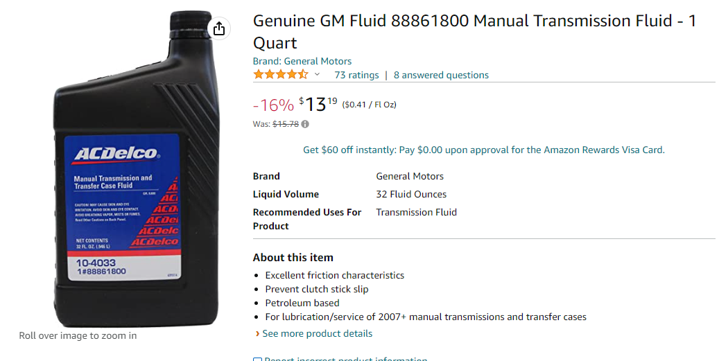

DO NOT USE DEXRON VI IN A DEXRON III OR DEXRON II in a transfer case
You WILL destroy it if not just cause leaks!!!!
What fluid is the OPs transmission? If you have a dex/merc fluid in an automatic, use the same one. if you have a gear oil in a manual (or whatever) then use
Dexron III which replaced Dexron II in the early 90s was directly compatible with Dexron II, but Dexron VI being fully synthetic and having very very different foam characteristics is not ideal in a chain transfer case especially that old(seals compatibility issue)
This is the only fluid on this planet that is "Dexron III" sold new. Its not called dexron 3 because GM replaced dexron III for all uses except Power steering and tcase/manual transmissions with dexron vi.
