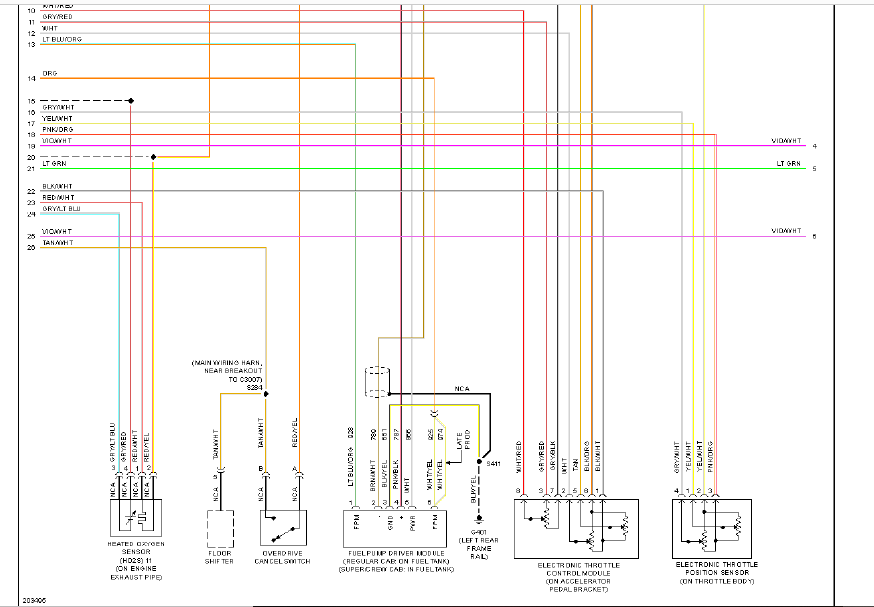

Did you take pictures of the connectors and wires before starting mod . I wonder if you broke a connection if you changed plugs out . Just maybe you interrupted a feed to gas pedal . I like to make a hand drawing as well as pictures so i can recreate connections . I don't have a drawing of the gas pedal circuit yet . So I dont know how it inputs signal to get to throttle body . I have a feeling that the gas pedal signal goes to pcm then pcm sends encoded signal to throttle body circuit board that drives throttle body motor .
I had trouble with mine going into limp mode years ago but it turned out to be a factory bad series of throttle bodies. So I started looking at it but cant remember much . But mine would shutdown to avoid the dreaded stuck throttle situation . If the feedback to the ecm doesn't match it shuts down .
Your best clue is you disturbed the wiring so maybe your gas pedal doesn't have power or ground .
I have some drawings so I will look .
I know you will be looking at gas pedal wires and test points for missing stuff . You didn't disturb wiring in engine compartment from pcm to throttle body by working on radio .

possible you knocked out a fuse in passenger kick panel. Especially f33 the gas pedal has many wires ,goes thru a lot of drawings . We would need to make up a large drawing to simplify a circuit just for gas pedal to pcm and fuses . It has more than one rheostat in it , looks like three . It has some common connection feed points used for other purposes so that would involve wiring routing to see if that point okay .
I don't know the philosophy of this circuit as a check point to make sure it doesn't give false signals which could cause runaway throttle . Its going to take some digging .
It just sounds like it lost a fuse feed or a power wire was interuppted .
Not an easy layout , needs a handrawn large drawing . Trace each wire by color to its source .

I was wrong about f33 , i cant find any fuse directly going to gas pedal all sources are coming from pcm . So the pcm is powering those circuits so check all fuses .
