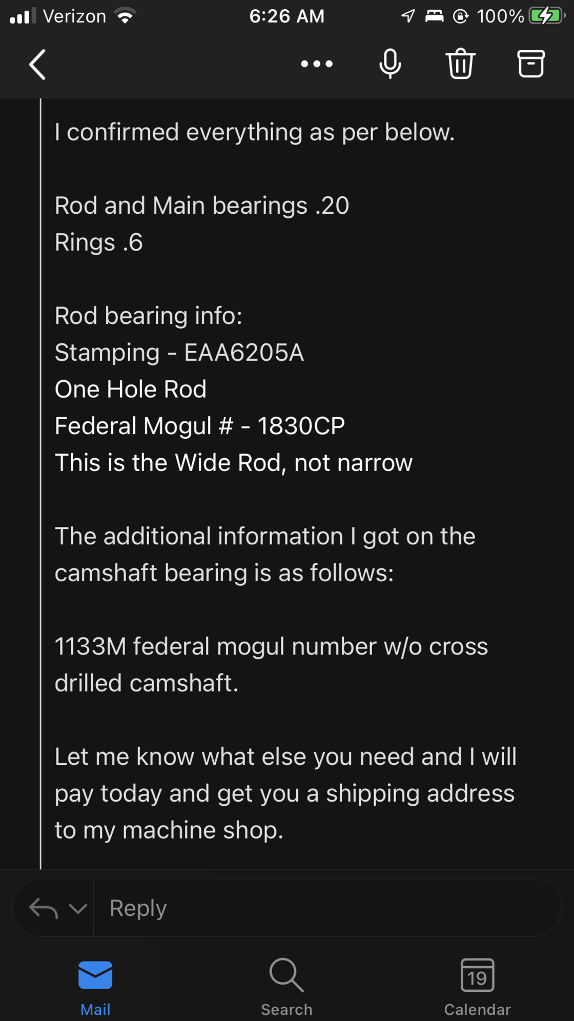

I just rebuilt my motor. A complete kit is closer to $1500. Be ready, once you open up that motor you might find you can’t simply rebuild it without machine work. I had 2 different motors and had to use the crank from one and the block from the other as well as other parts from a mix if the 2 and either one would have had to be over bored.
Kevin at Clegg hooked me up. He knew everything about these motors. Most importantly there are 2 different rod style bearings depending on the year and different camshaft styles. I have it documented in the pic of the email attached, so look closely! You need to look at the stampings on the rods and what hole configuration there is on the bearing. You also need to know if your camshaft is cross drilled or not. There is a wide and narrow rod bearing which is not evident when you are shopping online. If you want me to send you the complete email thread of the exchange I had with Kevin at Clegg PM me your email and I will forward it. It will save you some time.
I had to have mine bored .60 over and had to have custom rings made. I needed new rods, pistons, cam and all the bearings along with lifters and pushrods. My machine shop happened to have piston rods and my crank had to be machined .20 under. The parts from Clegg I ordered were $350 but only the ones listed in the email.
All the other parts were extra and I also needed a timing chain and gear, gasket kit and other parts.
