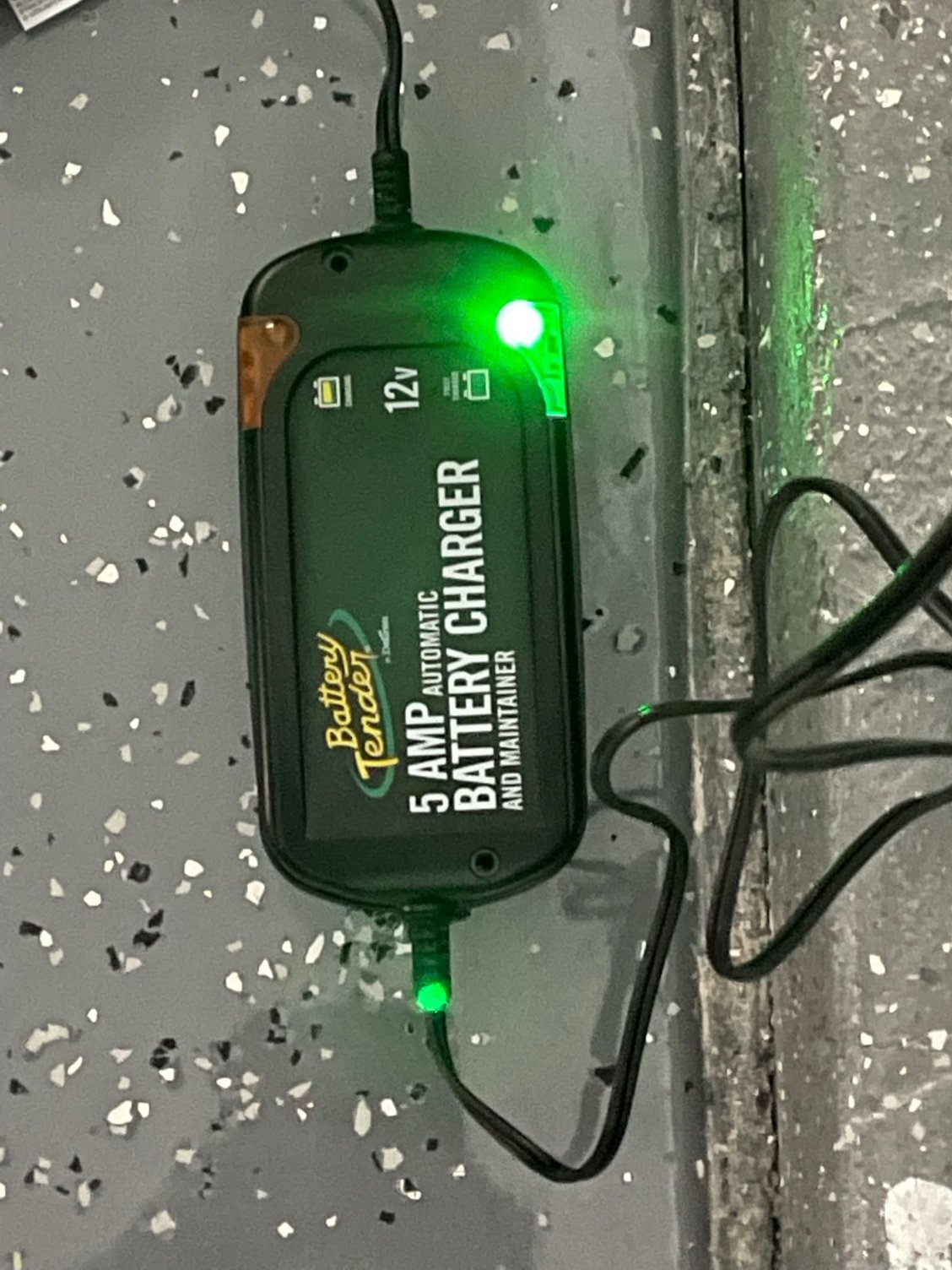

On my 2020 f350 6.7 with dual batteries, is it ok to put it on a matience charger? At home My truck sits for extended periods off and on. I have gotten the message on my app once in awhile when I’m gone for extended periods saying it’s in sleep mode. the truck is used for some short runs while I camp host and it is not at home on the charger. That’s when I got the message. I think I’m going to start charging it also when sitting at the camp host spot.

Sure, you can use a battery maintainer, no issue at all, many owners do that.
But, sleep mode is not something telling you there is a problem, truck goes into sleep mode after a certain amount of time any time you shut it down.
My truck, unfortunately lately, sits for 2-3 weeks between being used, no issues at all so far and I don't use a battery maintainer.

thanks much for the response. I’ve had a battery maintainer on it for a year now and I was hoping that I didn’t cause some problem with it.
I think this truck sat for a very long time before I bought it and the batteries got very low because when I brought it home and I put it on the charger it took more than 24 hours to get a full charge so the batteries might’ve taken a hit sitting so long. Also I’ve wired in the wiring the way you’re supposed to for a maintenance charger and I didn’t want the dealer to see that and blame me for something.

I put my on the charger all the time. I'm gone for work for a month+ at a time. I still get the sleep mode notifications even when it's been on the charger for days.

My '17 still has the original Motorcraft battery. On day 7 without driving it, on the charger it goes. Usually takes 3-4 hours on a Schumaker smart charger to reach full charge.

Get a good battery maintainer, not the cheap Hobo Freight model. I've heard good reviews on the NOCO brand and the Schumacher brand.

I would go for NOCO or something that has ability to do Lithium and AGM. Why? Because that way you can use it for anything and everything. I gave away all my other ones when I went to NOCO. That way, the attachments fit and I can switch it around for my UTV and Trike and watercraft batteries as needed instead of fumbling around trying to find the right one.
