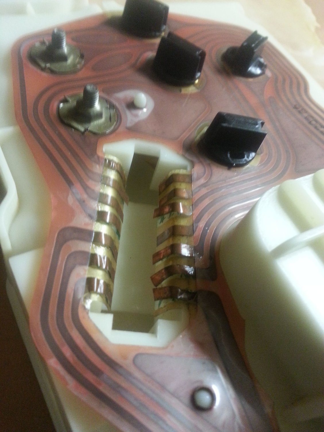

You could pull the cluster (carefully they are often brittle) and check and clean the printed circuit on the back. Use a pencil eraser to scrub the contacts for the bulb holders.
Also, check where the harness plug goes. On mine the copper strands had separated from the backing. I was able to use UV activated super glue to get them attached again. (4 1/2 years and still working)
Then trace were the light circuit goes to the plug and use a 9 volt battery and some test leads to see if you get light.
