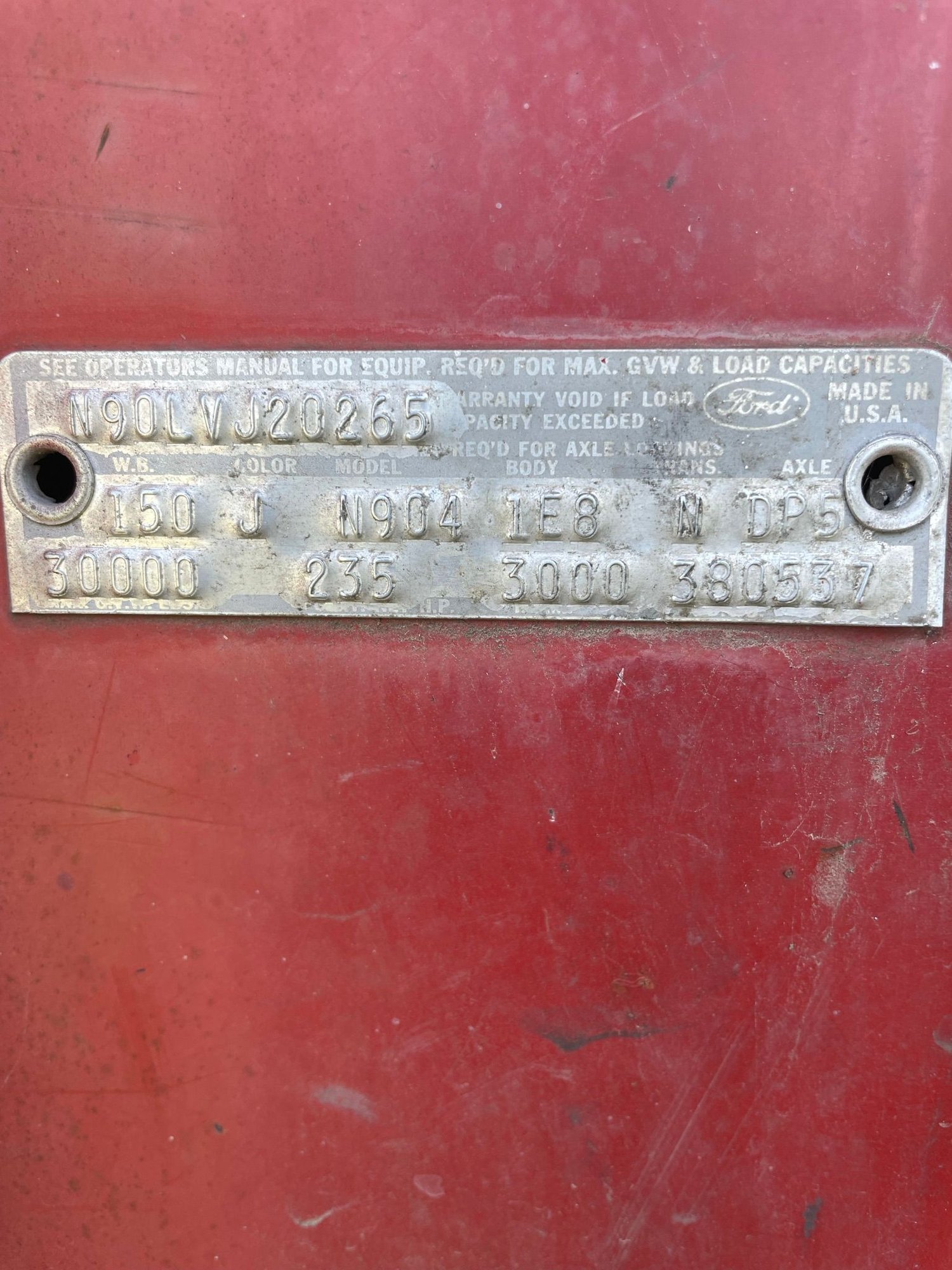

LN 900 decodes
Red construction type dump truck

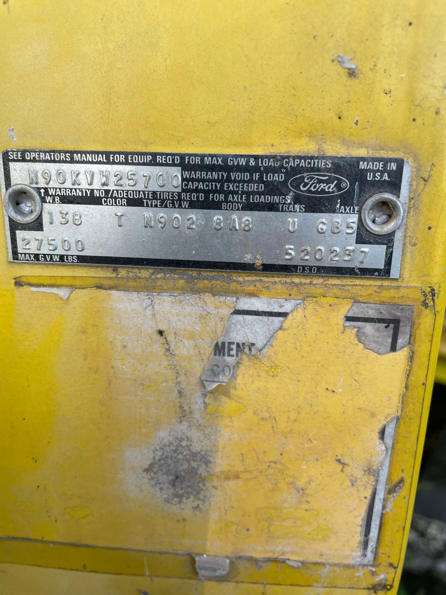

Yellow semi-tractor truck
Specifically trying to figure out what motor my trucks have. Any other information would be great also. Thank you

For clarity I'm going to give you your own thread, and make two posts for the decodes.
https://cimg8.ibsrv.net/gimg/www.for...041a3fdd3.jpeg
N90LVJ20265, "Red"
N90 = LN900 gas
L = 534 4V Super Duty gas (& plenty of it) V8
V = Kentucky Truck Plant
J20265 = 1970 numerical series, May 1970 production
150 = 150 inch wheelbase
J = Red
N904 = LN900 gas, 30,000 lbs GVWR, model years '70-'72
1E8 = Standard cab without butterfly hood.
N = Dana (Spicer) model 6352 five speed direct transmission
DP5
DP = Eaton model 19221 two speed rear axle, 23,000 lbs capacity, 6.17 / 8.40 ratios
5 = Ford 9,000 lb capacity front axle without power steering
30000 = 30,000 lbs GVWR
235 3000 = 235 certified net HP @ 3000 RPM
380537
38 = Pittsburgh District Sales Office
0537 = Special Order Number

https://cimg9.ibsrv.net/gimg/www.for...ca38bc99c.jpeg
N90KVW25700 "Yellow"
N90 = LN900 gas
K = 477 4V Super Duty gas V8
W25700 = 1975 numerical series, January 1975 production
138 = 138 inch wheelbase
T = Red (?--unless this is repainted, which given the paint near the warranty plate and the original rivets seems unlikely, perhaps it's a typo. "G", just under "T" on the keyboard, is Chrome Yellow)
N902 = LN900 gas, 27,500 lbs GVWR
8A8 = Standard Cab without butterfly hood
U = Dana (Spicer) model 6852-G five speed direct transmission
GB5
GB = Eaton model 18221 two speed rear axle, 22,000 lbs capacity, 7.17 / 9.77 ratios
27500 = 27,500 lbs GVWR
520237
52 = Dallas District Sales Office
0237 = Special Order Number

Thank you. Thank you. thank you. My family knew little to nothing about either truck. Dump truck is even titled wrong year and can now be fixed properly. Now to go parts hunting.
