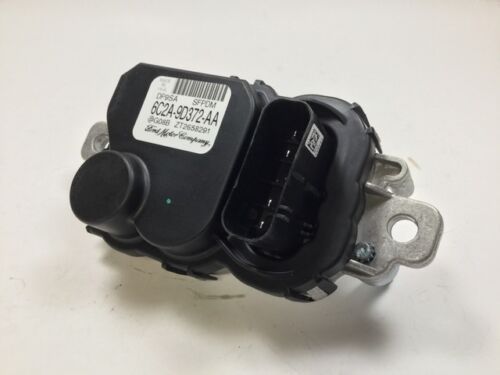

The fuel pump driver module?
Des it look like this?

Next to the spare tire on the 04-10 E series

That is it--what is it's purpose?? Thanks, Bill

It provides power to the fuel pump
