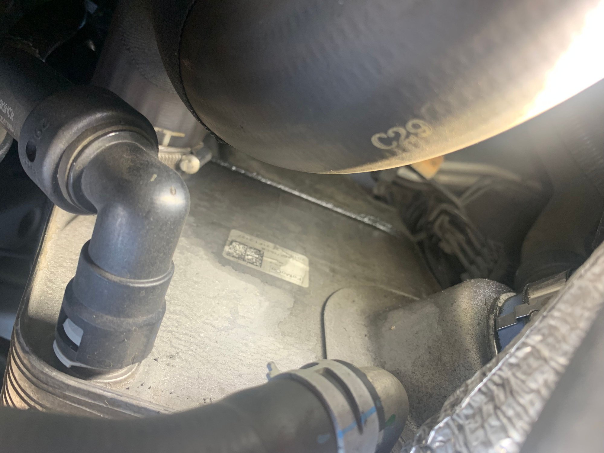

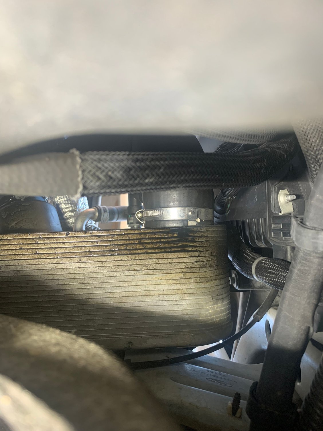

Changing coolant today and noticed a collection of oil. Is this “normal” or is it an indication of a problem just beginning to develop?

2017 6.7 Super Duty SRW with 104K miles.

Looks to be your intercooler and cold side pipe? I'm no expert but I do believe it is normal to have some oil in there because of the ccv. Over time it looks to have seeped out a little. As long as there are no cracks in the pipe I would think you are ok.
