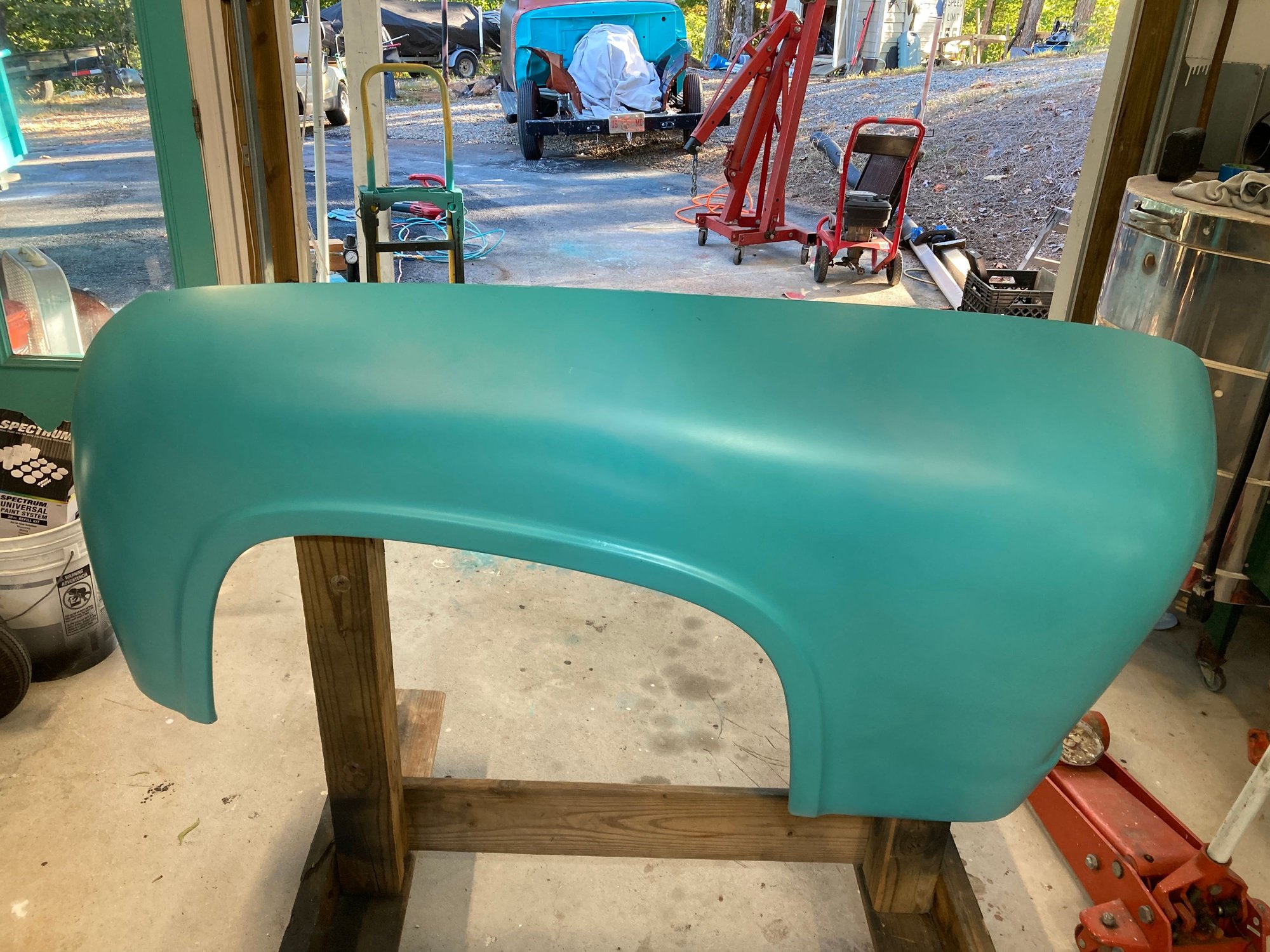

I priced mat clear coat at a local paint supply and @ $240 per quart, it just didn’t pass the grim test, so I decided to use some gloss clear that I had laying around in the hopes that I can figure an easy way to remove the shine and make it look more like a mat finish.
Two questions-thoughts:
1. Does anyone have a recommendation on how to remove the shine from clear coat? Or for that matter should I even attempt it.
2. I have never intentionally played with painting patina and obviously haven’t a clue beyond what I can read on the internet. Recommendation’s going forward are encouraged.
thanks

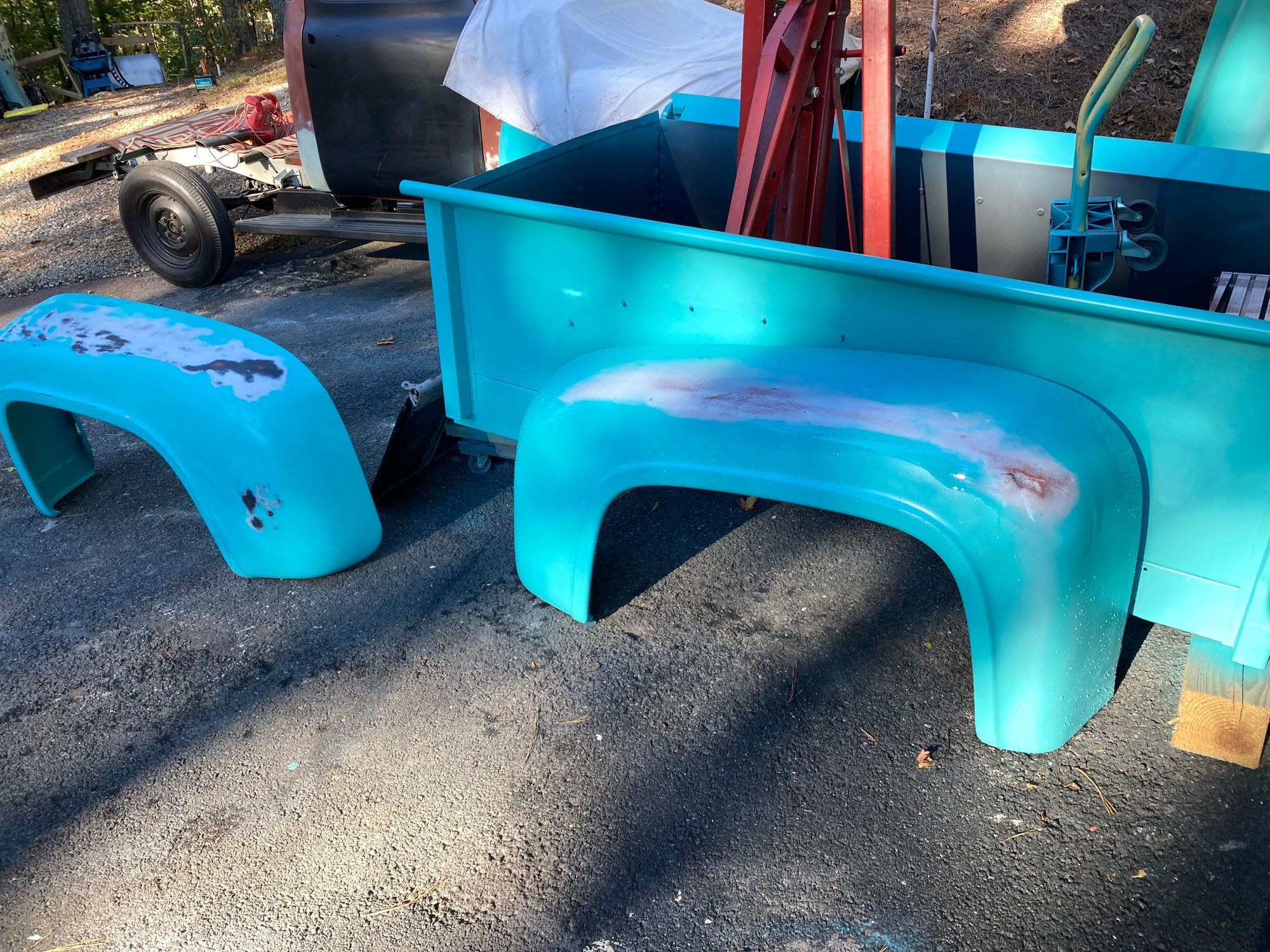

Driver front
Driver rear
Passenger rear - I actually like the way this fender came out. Not as much black showing.
Passenger front - Saving the final fender for our 12 years old grand daughter to patina. Which supervision of course.

It appears there are many available options online for flattening agent and although temping, I think for now, I will try scotch-brite pads and see where that takes me. I did try 2500 wet dry sand paper on my first attempt, but I have a bunch of orange peel and the clear would need to be sanded flat - much more work than I want to put into a patina truck.

Thanks for the feedback. I’ve tried scotch-brite pads and they seem to produce the dull sheen I am looking for. The scotch-brite pad actually reaches into the imperfections (orange peel) that would normally be sanded smooth during the color sanding process. After it is all said and done, I might just stay with the gloss finish. I’ve seen high end patina trucks on line with gloss clear and it seems to have a following. Time will tell.
