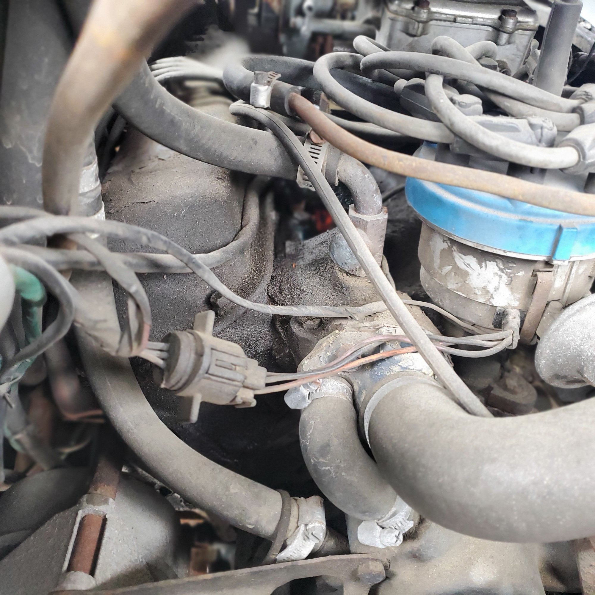

Hi All,
I have a Ford 302 and I am trying to confirm what year range it is
Please me with the engine year (or year range) and the horsepower rating
it is a blue 302
it has a carburetor
it doesn't have a serpentine belt , (per-1979?)
The driver side valve cover gasket is vented.
Any help would be appreciated
Thanks

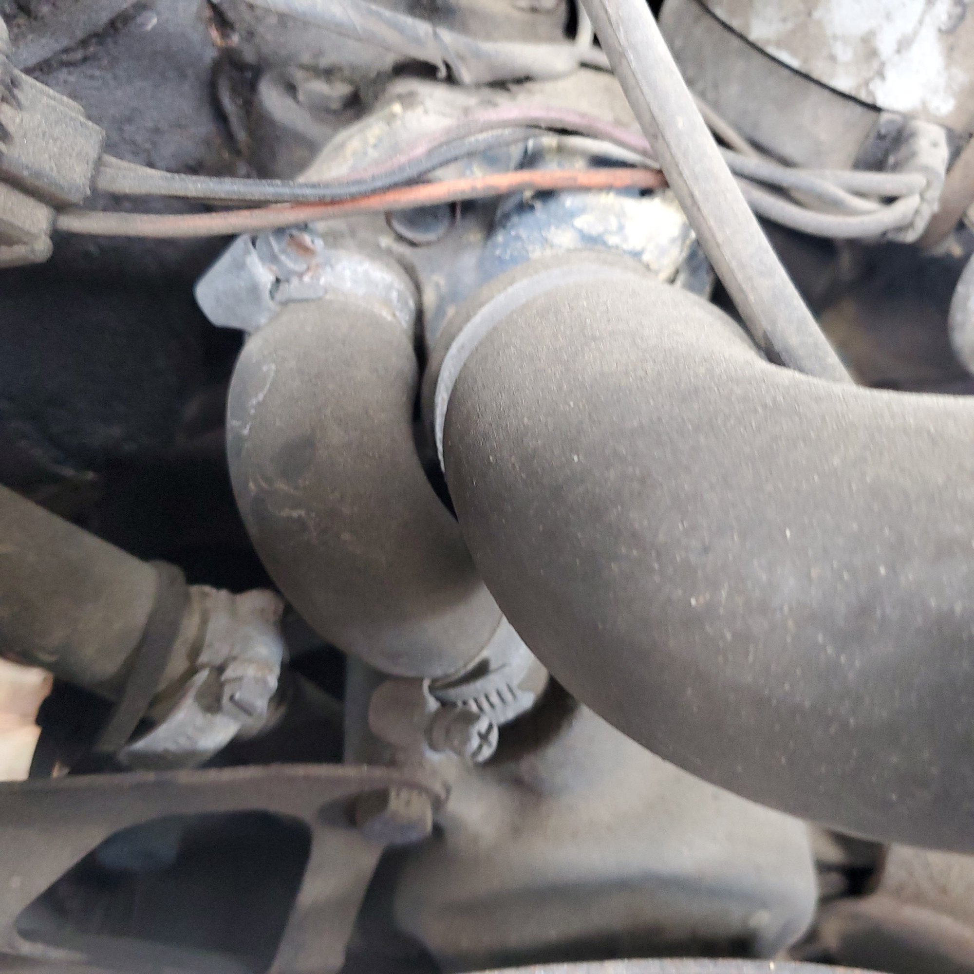

thermostat housing

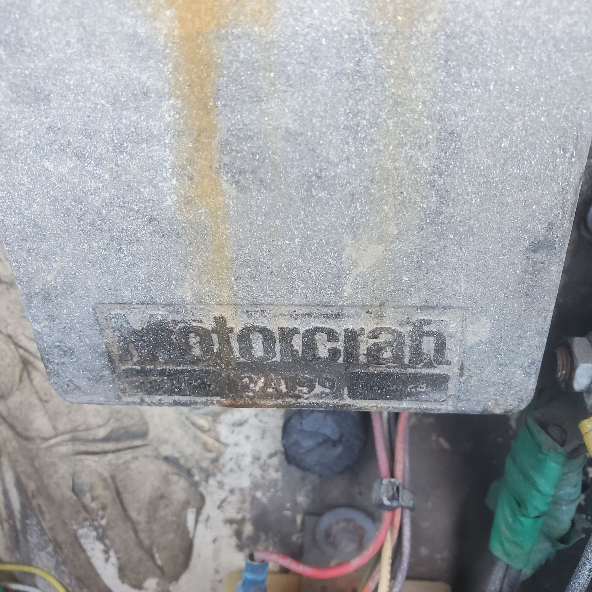

motorcraft computer seems to be part number 12A199
dipstick reads warranty requires SE/101-c oil
DITE -6750-BA

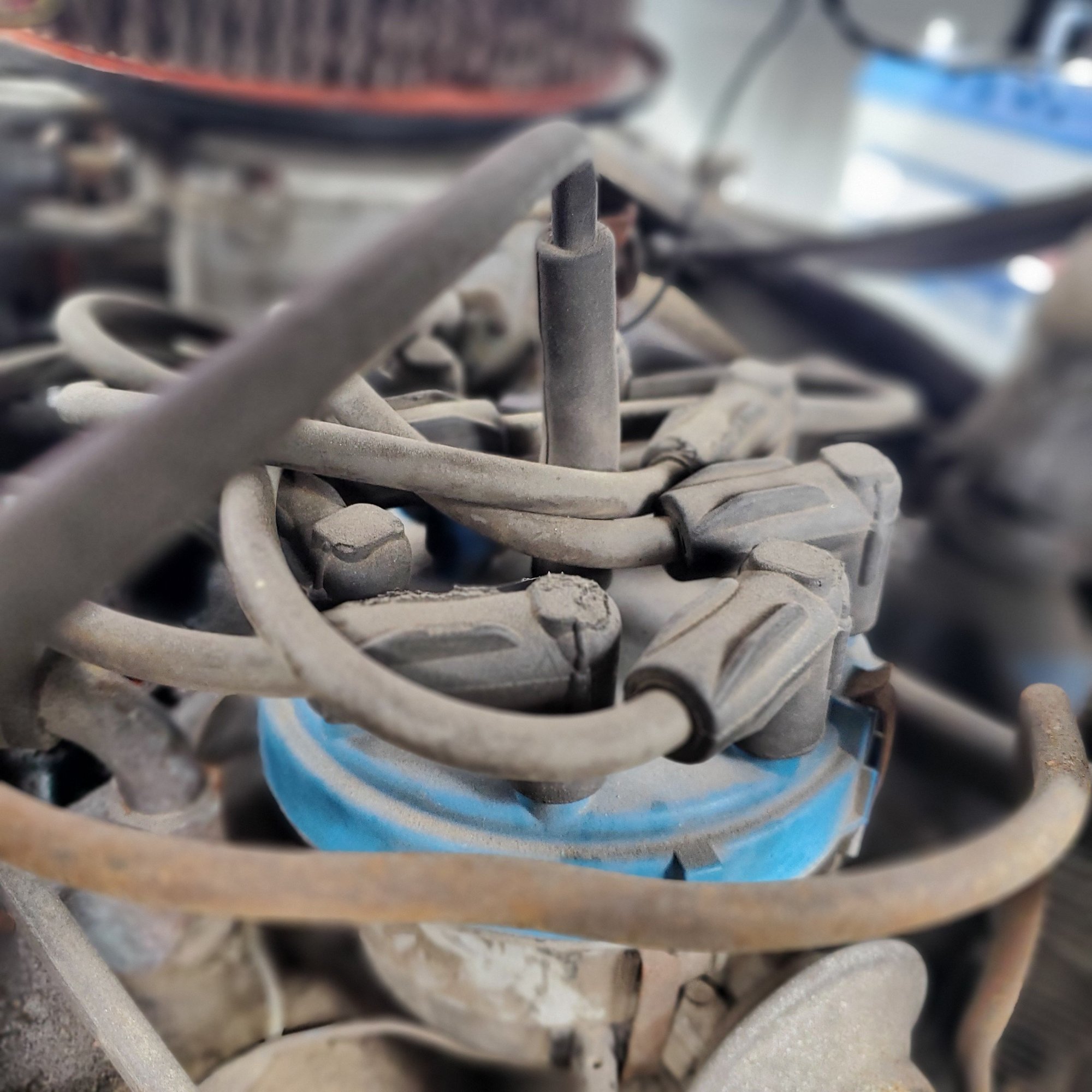

Looks like a mid to late 70's model. Look for the date code on the area above the oil pan rail above the starter.
That's an ignition control module, not a computer.

If the motor isn't original to the vehicle there is no way to know exactly what it came from, but the general vintage can be determined from the engine block and cylinder head casting numbers. Block casting numbers are on the side of the block down by the starter, head casting numbers are either under the valve cover or on the lower side of the head depending on the vintage but the intake would have to be removed to see those.
Based on the fact it has a carb and v-belts but electronic ignition it's most likely to be a '70-80's motor, and an all stock motor of that era only made 130-150hp.

I believe Ford started using that ugly Duraspark distributor cap in 1976 or '77.

It's supposed to be functional, not so much attractive. The bigger cap spaces the terminals farther apart, reducing the chances of cross-arcing with the higher ignition voltage that comes with the Duraspark system.

I agree, the Duraspark system is a great ignition setup. But the early points style small blue caps are much more attractive.
And the Duraspark has a very nice personality.

The big caps came in gray later on. The sure look better than a coil setting on top of them. You can use the old small caps and rotors as long as the advance cure isn't too big or plug gaps. You can also get a big red cap from msd. I personally don't mind the big caps if it's on an appropriate year. The wire terminals are easier to deal with than the old style.

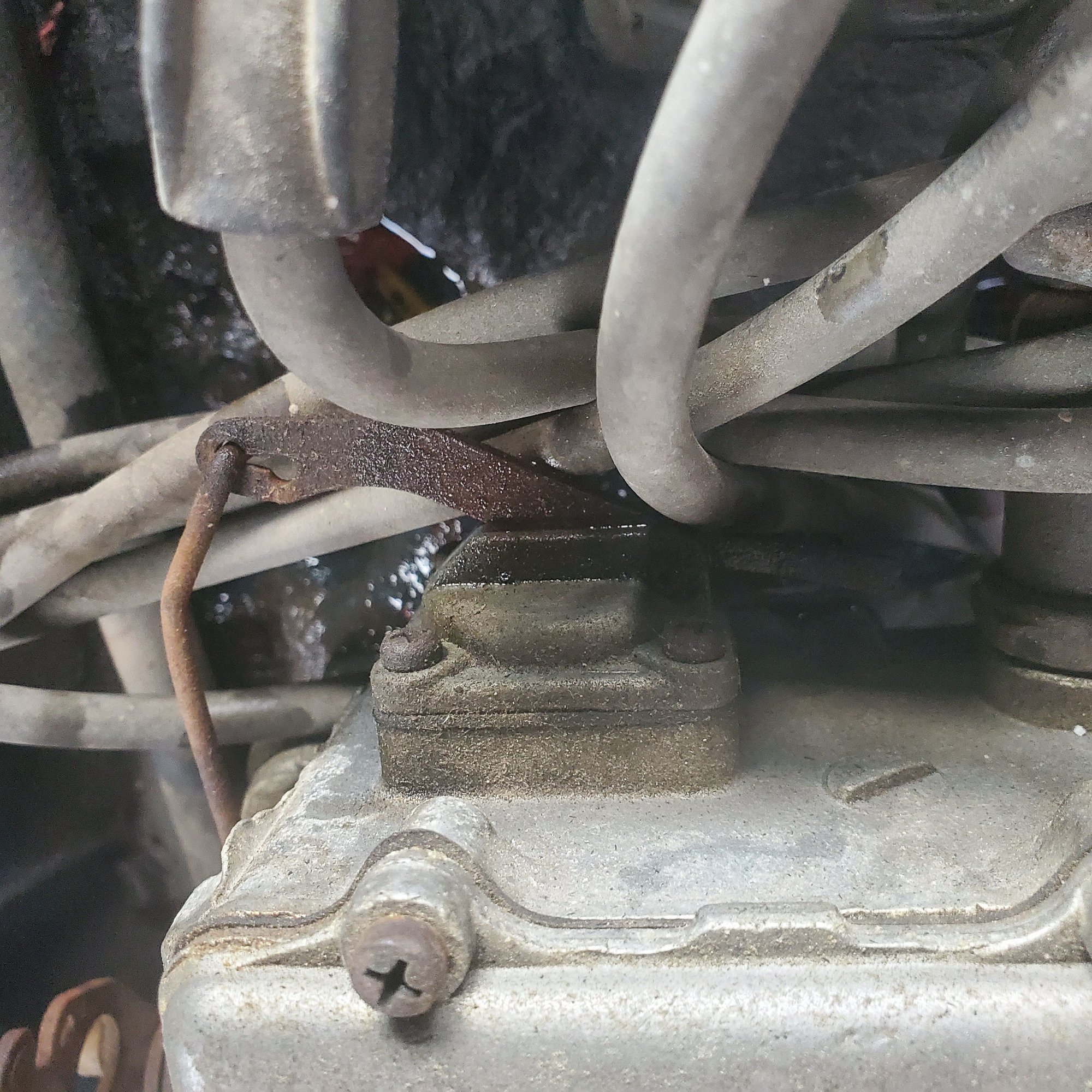

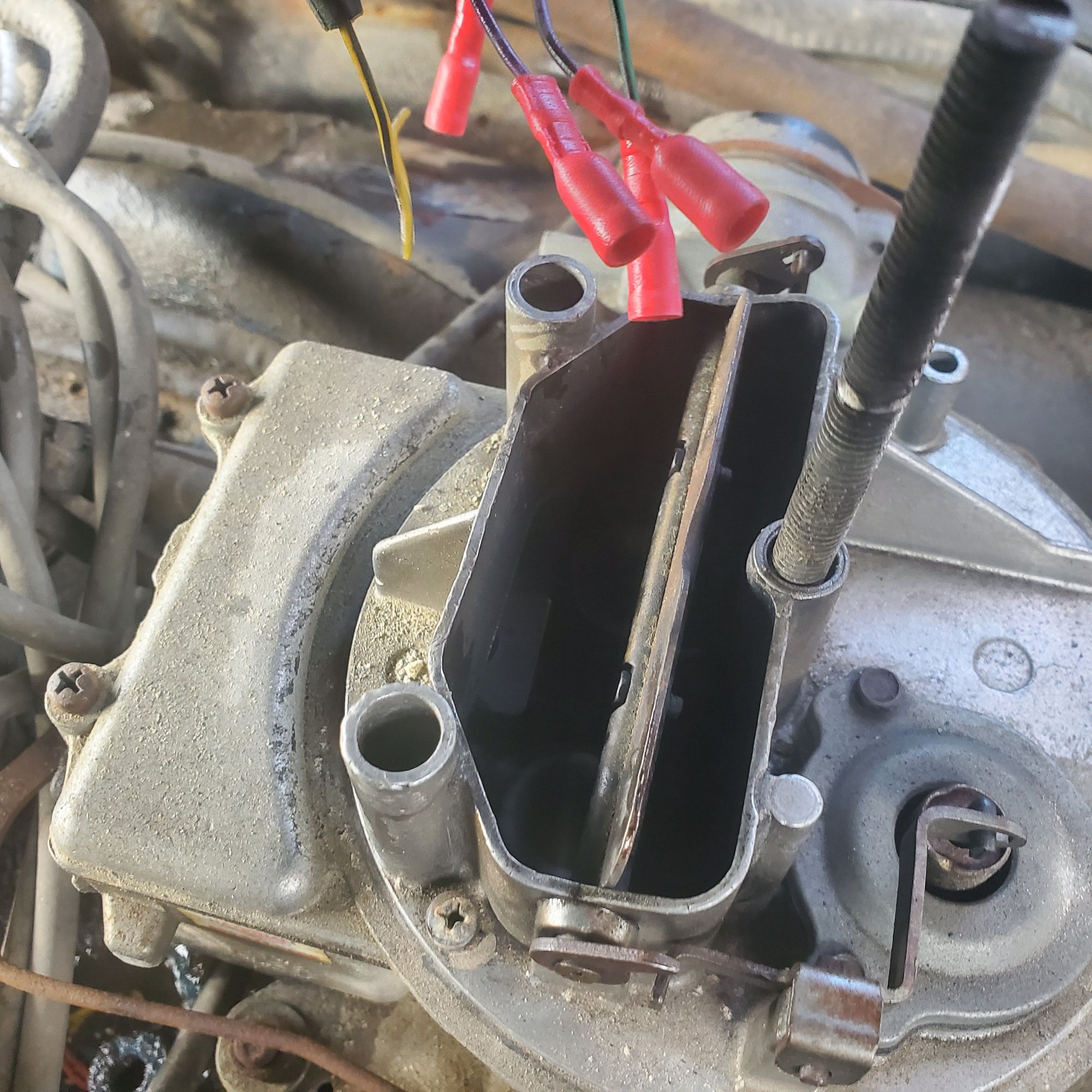

Can any identify the carb from the first picture, I need to order a rebuild kit?
I need to take more pictures, van is in remote location
The engine has been swapped into and old step van and it is hard to see everything.
i plan to pull the carb this weekend and will get more pictures, the ones I attached here were on my phone
Thanks everyone

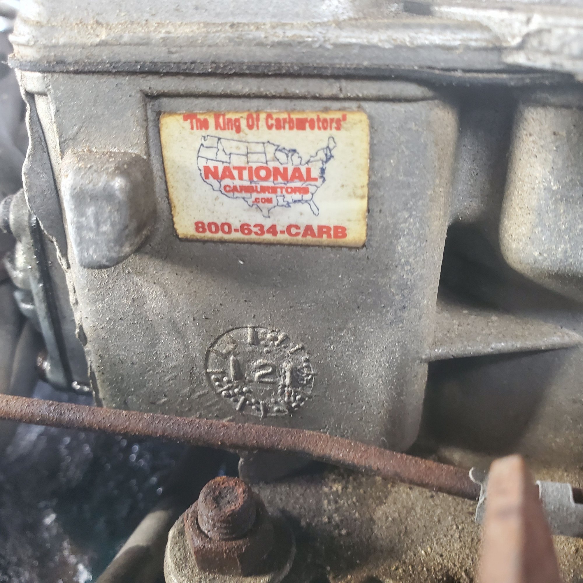

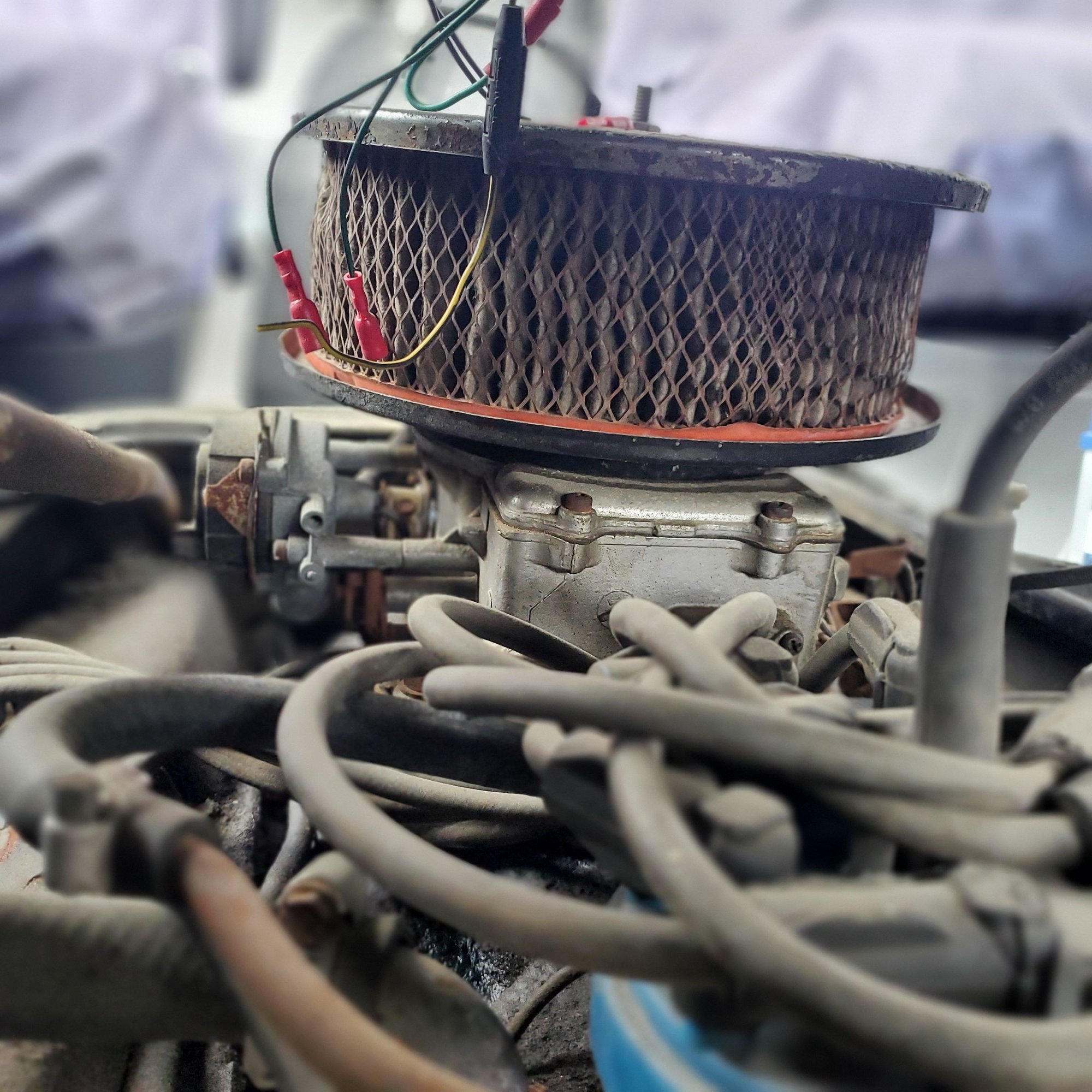

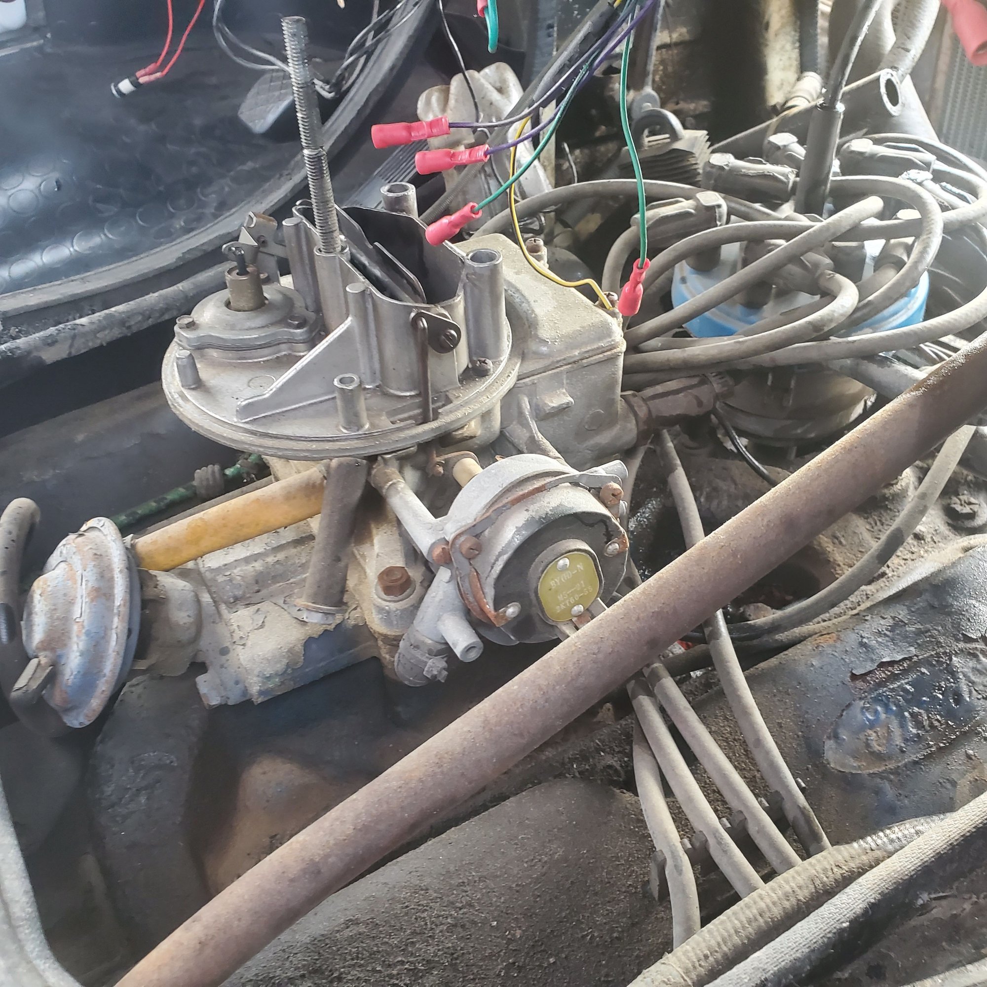

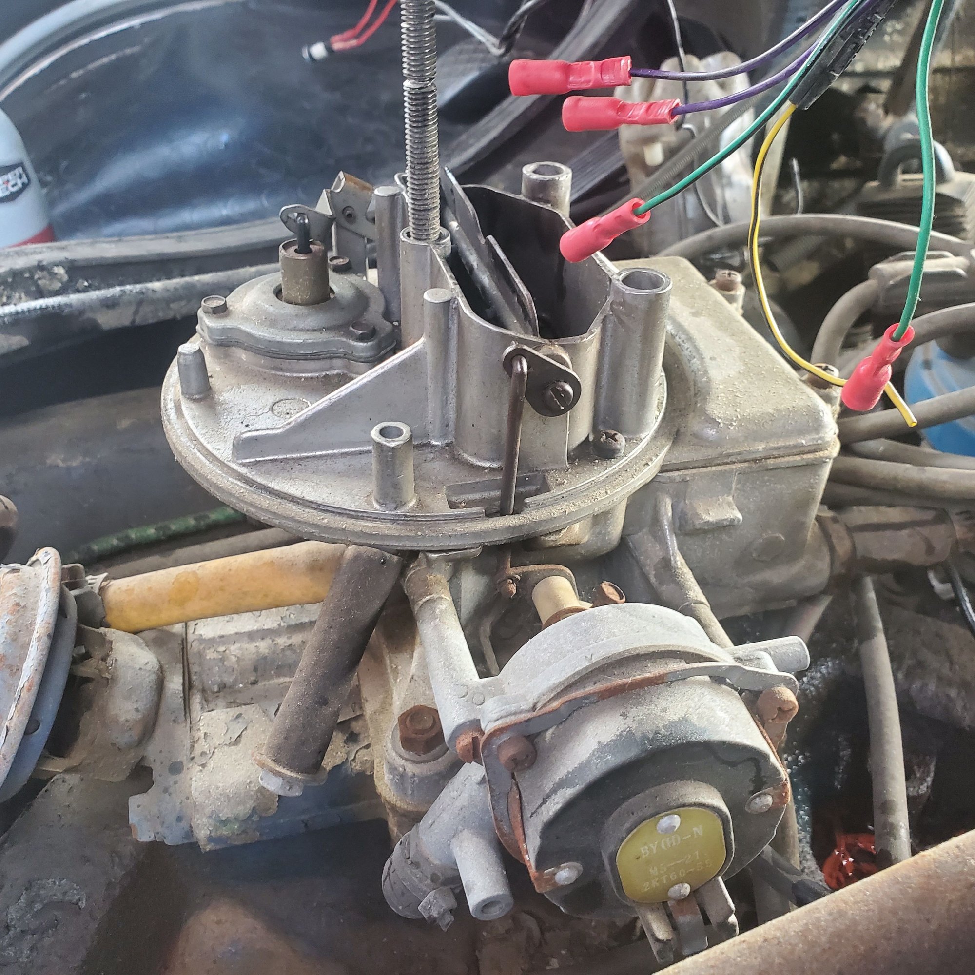

major leak from the front of the carb.
Not sure if this is a Ford factory carburetor
I can't find any easily distinguishable markings
looks like it may have been either remanufactured or built by national corporate.
it has a massive leak in the very front of the carburetor.
it looks to be coming from the gasket I in the front left of the last picture.
it needs a little starter fluid to start no electronics at all on the carburetor.
Thanks

I can't ID the carb, maybe someone else can.
The leak is from the accelerator pump, but you should go through and replace all the gaskets and seals. Once someone IDs the carb, get a rebuild kit, which should include a new pump diaphragm.
I had an old carb whose pump diaphragm had gotten stiff, probably from the alcohol used in modern gasoline, so that it would not actually pump when I opened the throttle, leading to major stumbling whenever I tried to accelerate. The new diaphragm that came in the rebuild kit I got was made from this green rubber, maybe it's more resistant to alcohol. It's been working for almost 10 years.
Old Oct 20, 2022 | 12:24 AM
85e150's Avatar
85e150
Joined: Apr 2004
Posts: 34,499
Likes: 2,811
That's a Ford 2150 2bbl, millions served. This outfit rebuilt it:
https://nationalcarburetors.com/ford...arburetor_1976
I just picked 1976 as it has a nice ring to it.
You can get a rebuild kit for that carb, and being close on the year is good enough as they were nearly all the same and the kit usually covers multiple versions.
That carb has the 1.21" venturi, which is one of the larger ones. You need all the oomph you can get.
The thing it's sitting on is the EGR. Those corrode and erode so be careful with it if you pull it off there.
You can remove it but then there's a bit of fiddling to be done. If it's not causing a problem it's probably best to leave it be until other items are tended to.
