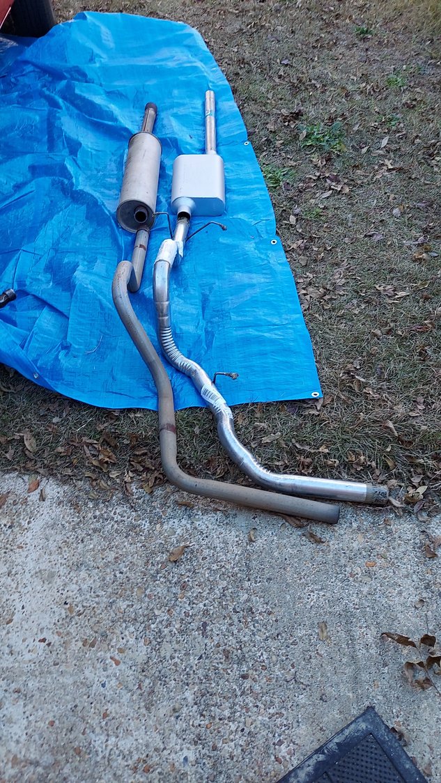

94 with welded Thrush muffler on the right old 81 on left.
The 94 is larger IIRC 2.25" factory, 81 think was 2".
It is not loud but I think has a nice rumble to it but being a six it will never sound like a v8.
What is nice with the 94 is I can get it at any parts store as it is factory.
Dave ----
