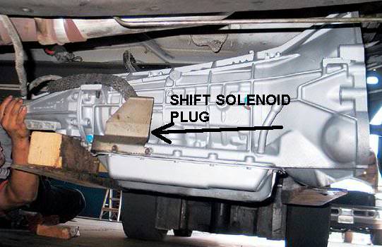

I have seen that before as the heat from the exhaust kinda melts those wires.
Ford put a heat deflector there to protect the connector but that connector is sometimes left off.
That is C1048 the Shift solenoid plug..

Yep, I'm 99% positive that's the one!
My transmission does have have the little cover plate there, but my exhaust is not original, and is even further from that connector than the factory setup was, so I wouldn't imagine heat to be the key culprit in this case, but who knows?
I won't rule anything out at this point...
