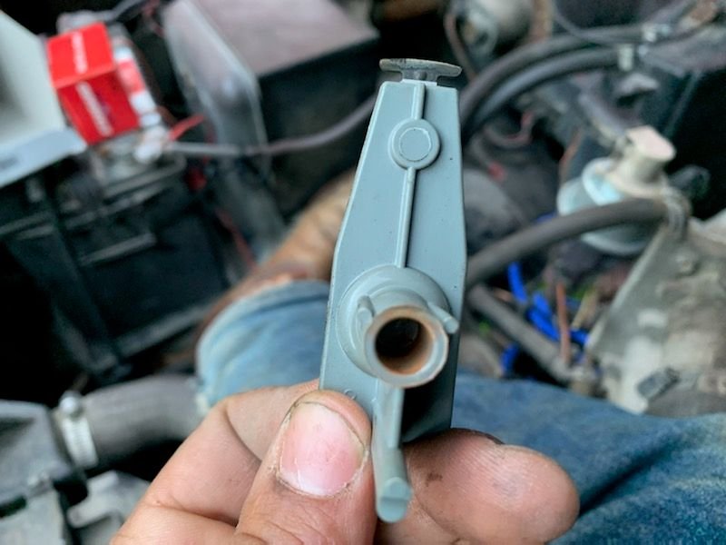

I started doing a tune up --distributor cap and rotor, plugs and wires--but ran into a parts problem. Below is a photo of the rotor thats in the distributor at the moment. Then a photo of the new one i ordered. They are not the same and the new one does not fit, but my parts lady says that this is the only one that comes up when she looks my truck up. Any help with this? The third is a photo of the distributor to show the rust inside the distributor. Im going to try to clean that up. Id love to not have to put in a whole new distributor right away..

Whats the part number on the new one she gave you? I looked up a 1986 f250 with EFI 302, and it did show the same one she gave you, plus a round bolt on style. I went to a 1985 f250 with a 302, and it had the one she gave you, the round bolt on style, and it did list the one you have as a push-on style. The part number was WVE 4R1088 I checked Autozone, they also sell all those different types, including your type under a 1986 EFI 302. Their part number is Duralast F981 which looks like yours and they also call it a "push on rotor".

Rotor is Standard FD307- looked up a 1988 f250 302, says with ECC IV ignition system.
