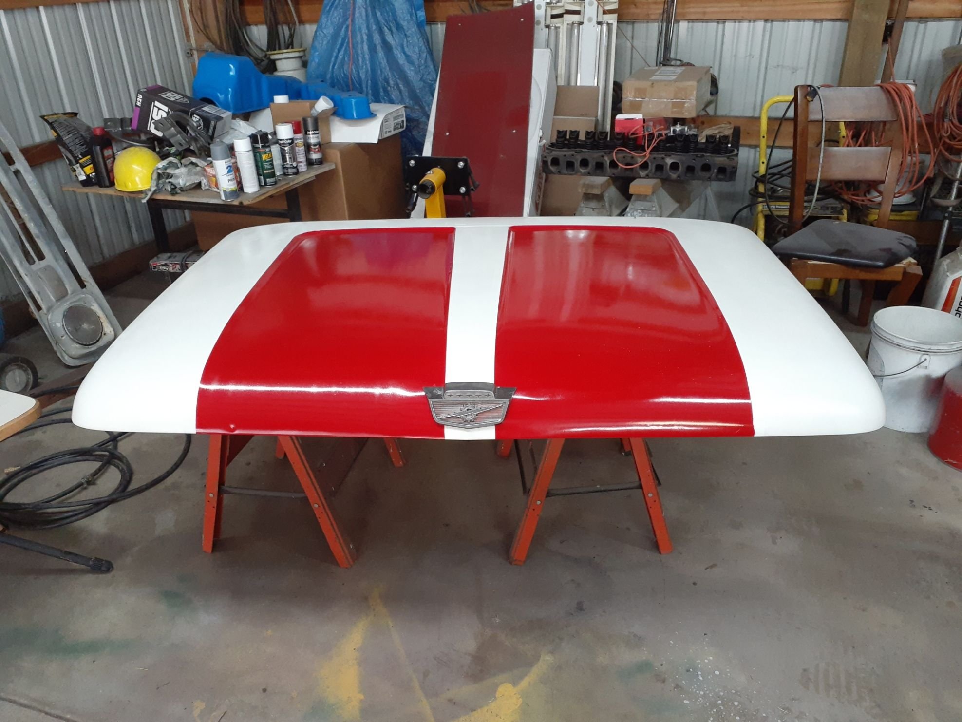

Since I had to put my engine rebuild on hold, thought I would work on other things. I fixed and painted my hood. It was all flat so it was easy to sand. The grill however isn't that easy lol. The paint is old and hard. I thought about a paint remover, but the body shop said the new paint remover sucks. If anyone knows of a good one that will work, I would appreciate it. Sand blasting or a fine wire wheel crossed my mind, but I don't want to damage the grill to the point primer won't fill the marks. So if anyone has any info on the best way for me to go with this, I would greatly appreciate it. ty
