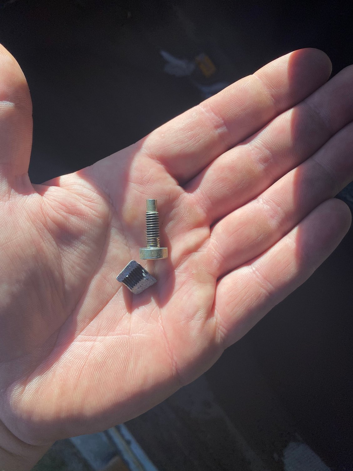

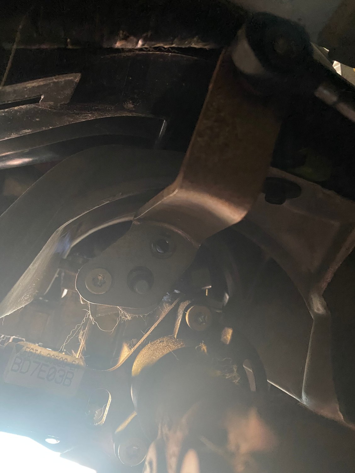

So I bend myself into a pretzel to look up under the dash and see the bracket from the transmission shift cable loose on the back of the shifter assembly. I can’t remember if I ever took that bracket off, or the bolts just loosened over time, but I was able to get it tightened back up to work for now on one bolt. It being loose allowed leverage to be put on the bolt and shear half the threaded casting off.
