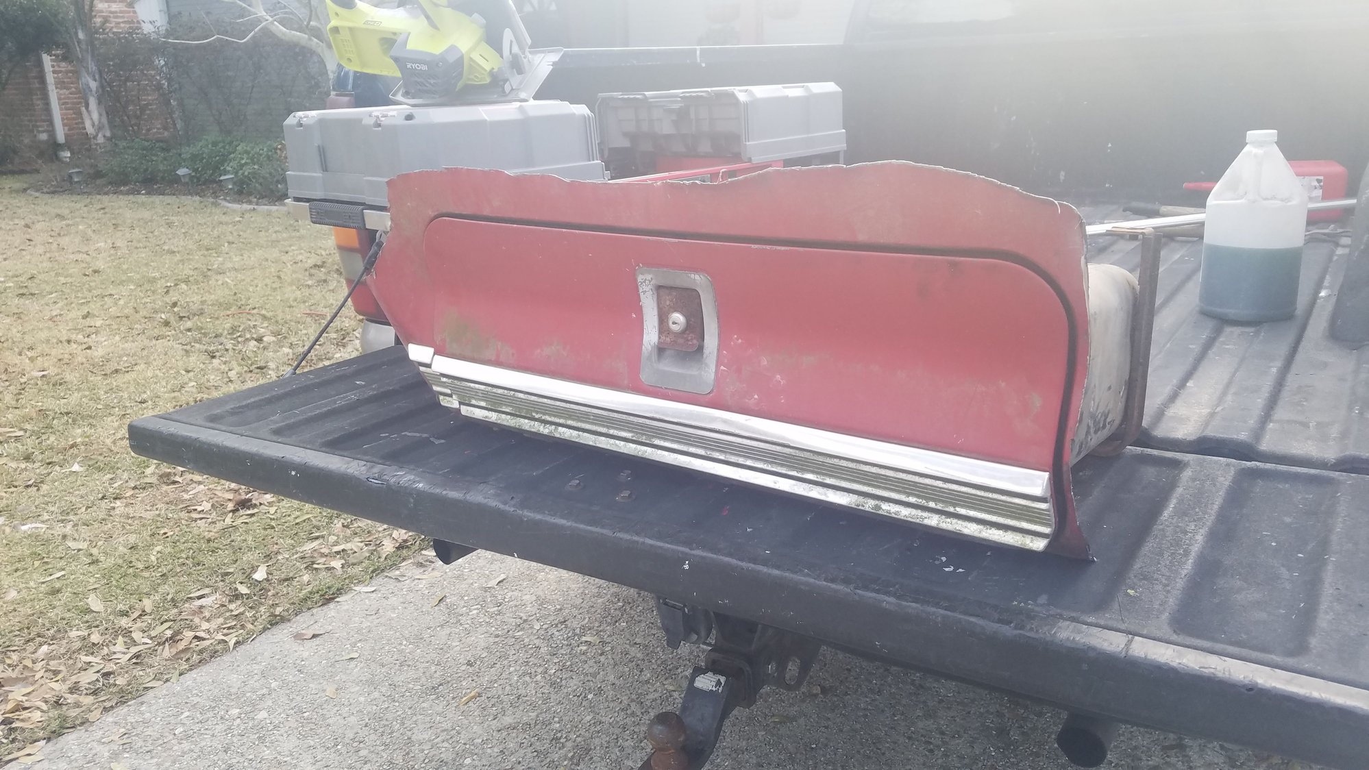

I suppose I could remove mine and wire brush and paint mine, but I just wanted to know if it is possible to buy one any where?

You mean a complete opening handle/latch/lock? I have not seen one of them for sale. Now if you need just a lock, take the door off and take it to a lock smith.
D7TZ-9946112-A (replaced D3TZ-9946112-A) .. Tool Storage Compartment Door Latch Assembly / Obsolete ~ Not reproduced. 1973/79 F100/350 Stylesides // No Ford dealer or obsolete parts vendor has any. Shown as 46112 in upper pic:

That's correct they're not reproduced and probably never will be . just too little demand.
I sent mine of an had it replated, cost $40 or something like that. you could tit it with something like Eastwoods bright zinc and probably you couldn't tell it wasn't plated. it's easy to disassemble it and remove the lock so you can do it right

Thanks for the good idea, 440sixpack. I think I will do that—send it out and have it replated. I'm getting ready to pull the bed and do the body work inside and out, and paint it with summit urethane and clear. Do you know a good DIY bed spray system?
