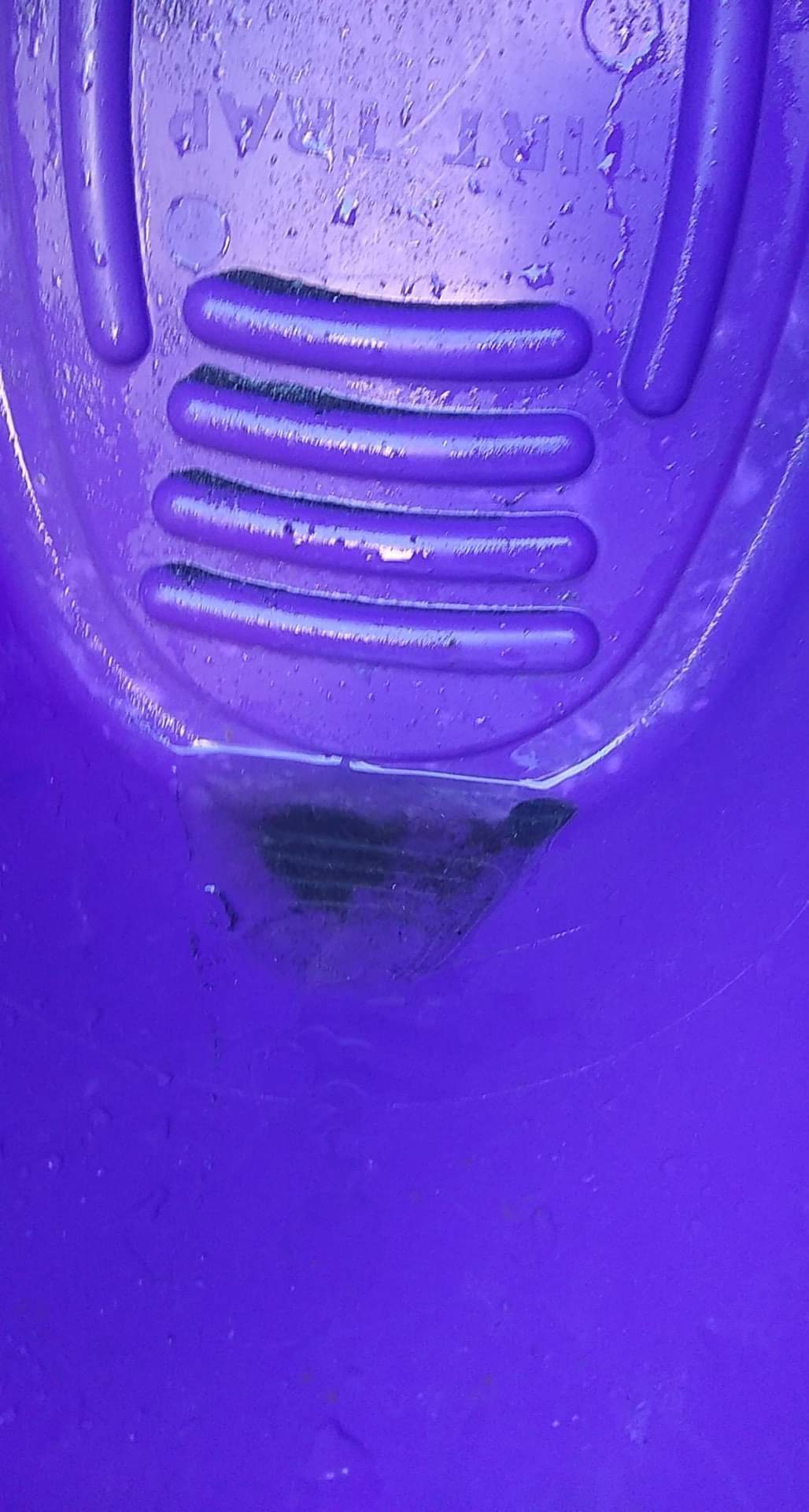

Look at what's coming out now?!
What do you think this is! Got to be a sticker or something right?

6.0? you'll get casting sand out if it for a long time. Coolant filter is the only way to go. Even after all the flushing, you'll get a load of crap in a filter. When I did mine, opened all the pet*****, radiator drain, and stuck a garden hose in the overflow tank and let it run for a while.
