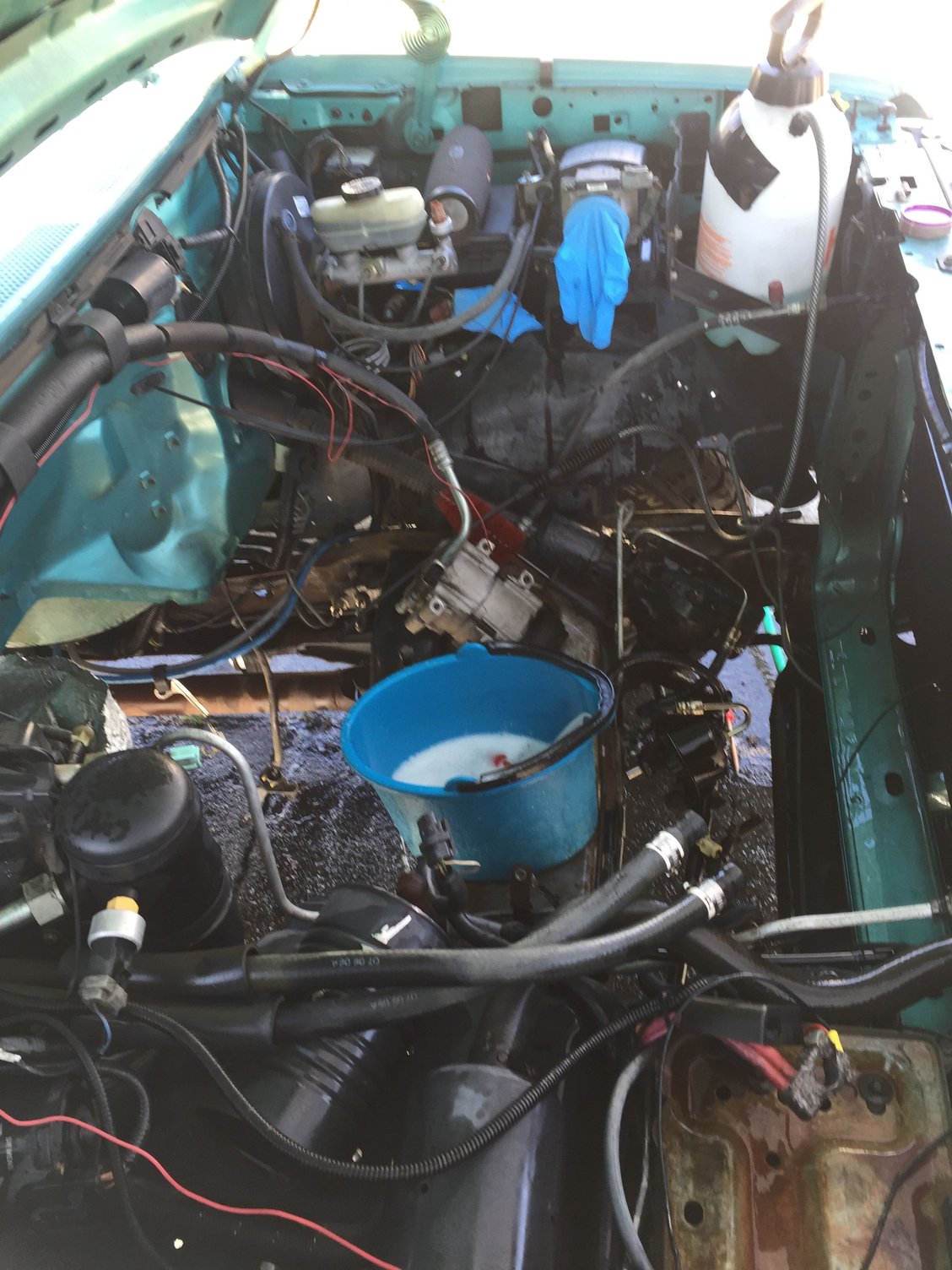

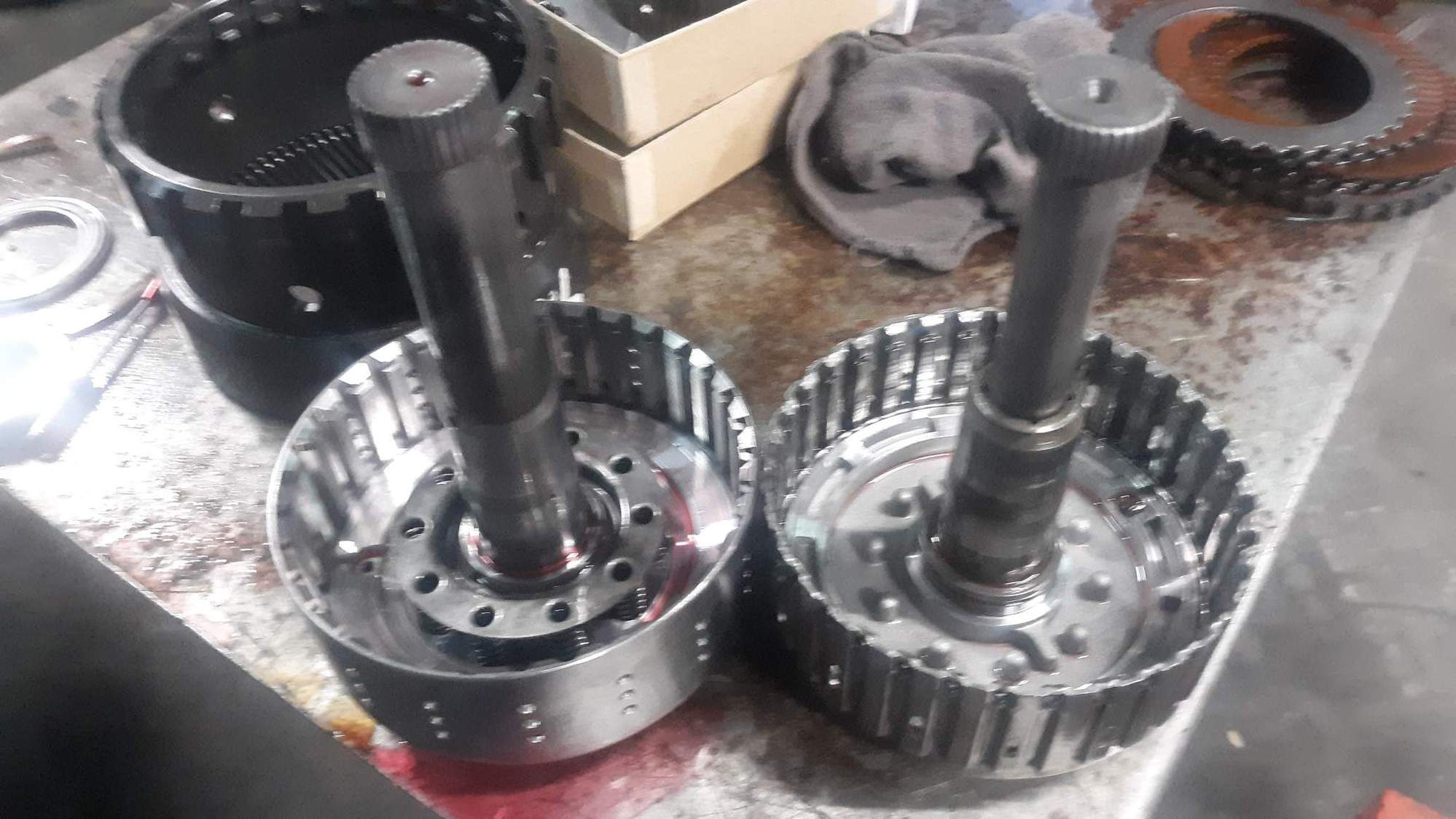

It's been a long road starting with my fuel pumps some of you may have seen. I said I would post this at some point. So here it is. About a year ago I had some time off work and tore in. I had the tcase, transmission and engine out. The blower went on a summit rebuild. I was skeptical of this route and have plans for another motor. This let me minimize the downtime though. The transmission got the Sonnax 3rd gear drum. The stock torque converter got cut into, fully brazed, and "tightened up" a little. I put a couple thousand miles on the engine in bone stock form minus cooling mods. I wanted to prove this setup for a while before the abuse came. I had lots of "fun" getting the blower in and hooked up properly.

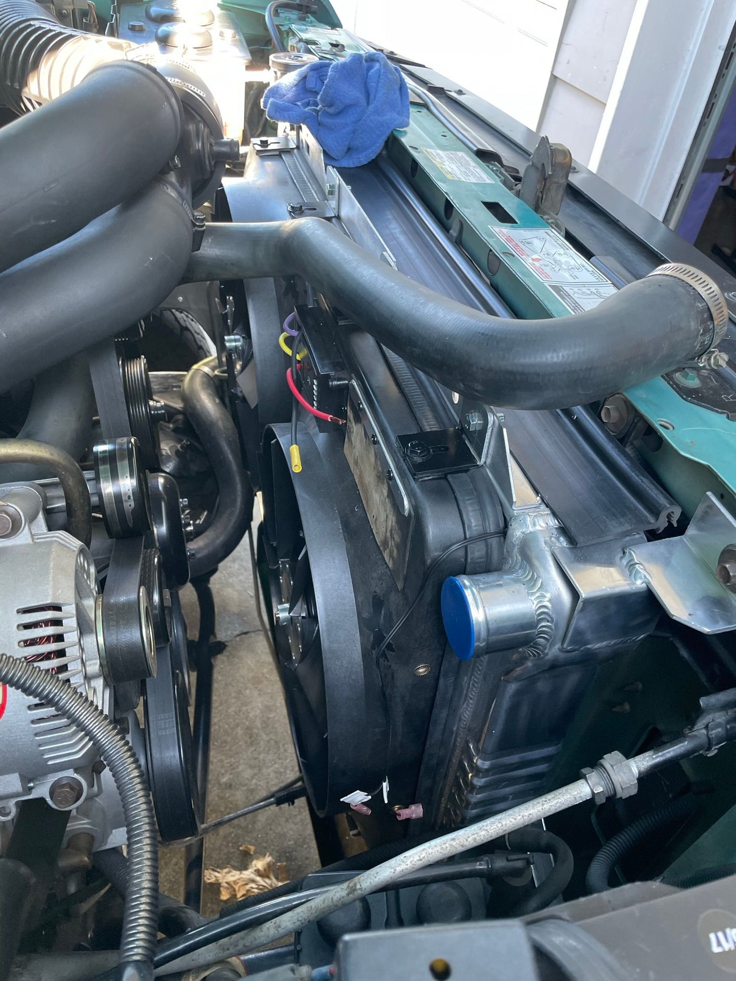

It's off at the tuner now. I did some driving around pig rich to make sure it would all hold together. I also wanted to verify my cooling. I love the fans and there's no way the oil cooler doesn't help. Let the questions fly.

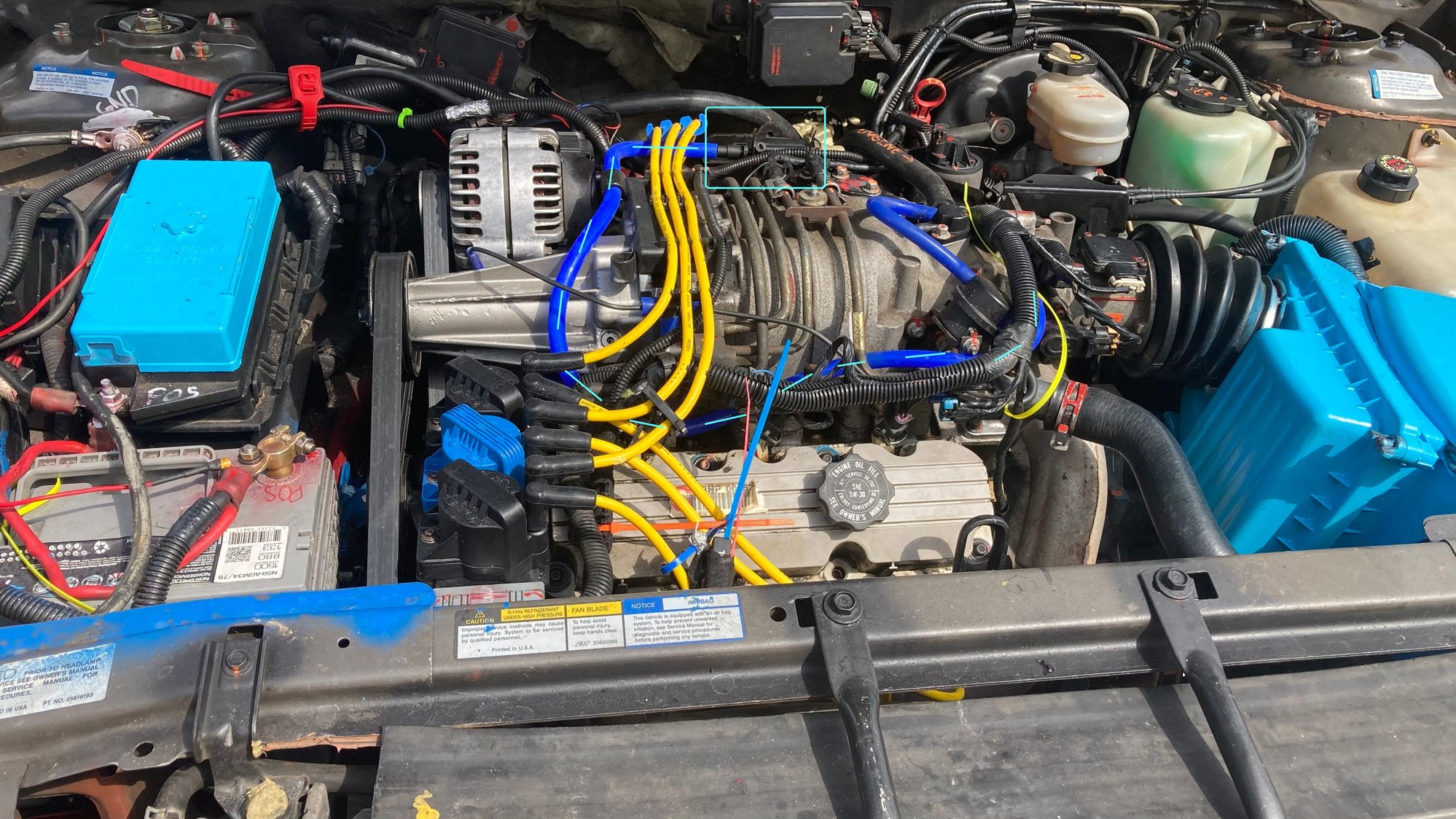

ignore the square by the purge valve And yes its GM, ive committed a sin And yes its basically stock 7-8 psi, I didnt want to push more because I boguht the car high mileage and its a park avenue (heavy)

Originally Posted by AuroraGirl
I endorse Supercharging
O.. the pain...
