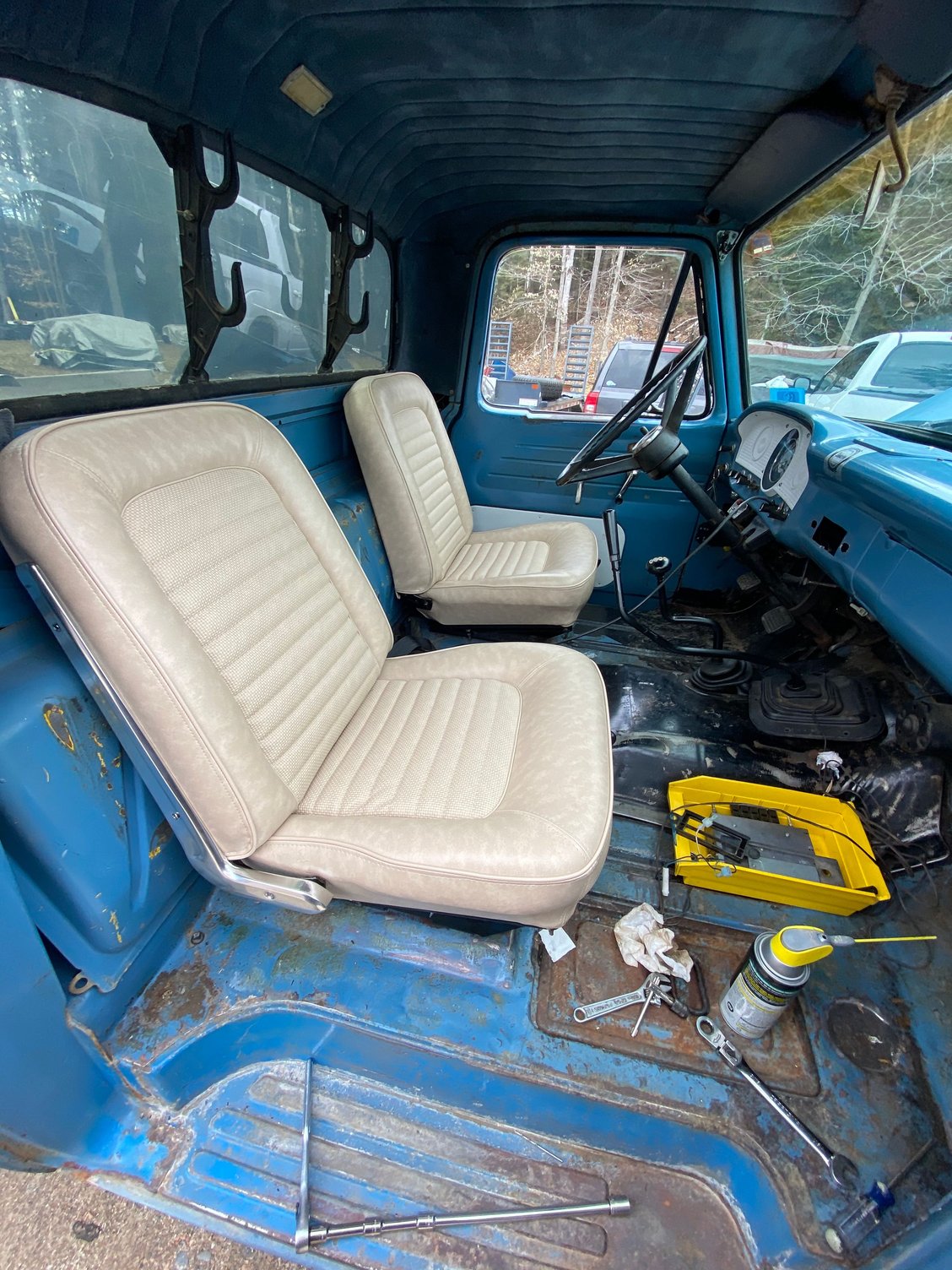

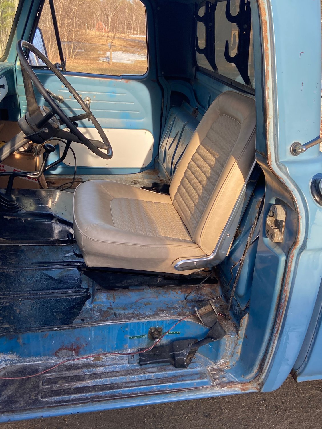

Here are some pics of a work in progress. It is a do-able DIY project with a few hours of time crawling around, and doing some research . But, if the pockets are deep; it shouldn’t be a month long process but rather 2-3 days including seat upholstery.
Don’t expect a noticeable improvement in leg and belly room (from the steering wheel). But, I’m 6-4” and 290 pounds… anyone with less height, and most people have less midriff girth than I should be fine regardless.
Fitting before paint and carpet:
