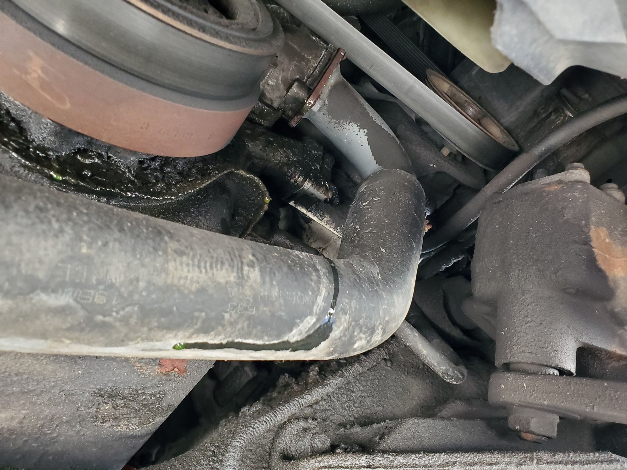

Some rust underneath
Newer front shocks
Coolant dripping down

Another spot of coolant leaking. Not 100% sure where it csme from, this is on the passenger side, and I didn't see anything there after driving it on the highway for about 30 miles

Just by the pics there's a couple of red flags, leaking coolant, oil dripping, rusty undercarriage, what looks like worn out front sway bar end links, most likely will need a suspension overhaul, all that amounts to some serious coin. To steep IMO. Look for another one, or hassle him for a lower price.

Retorqueing all the water pump and front cover bolts would probably fix the new leak. Don't want to go crazy on them, just another round at factory spec. If none really turn at that setting maybe try bumping up 2# but probably not much more. If I remember right factory spec is like 20# so 2 more is a 10% increase. I don't like to press my luck when aluminum is involved.
