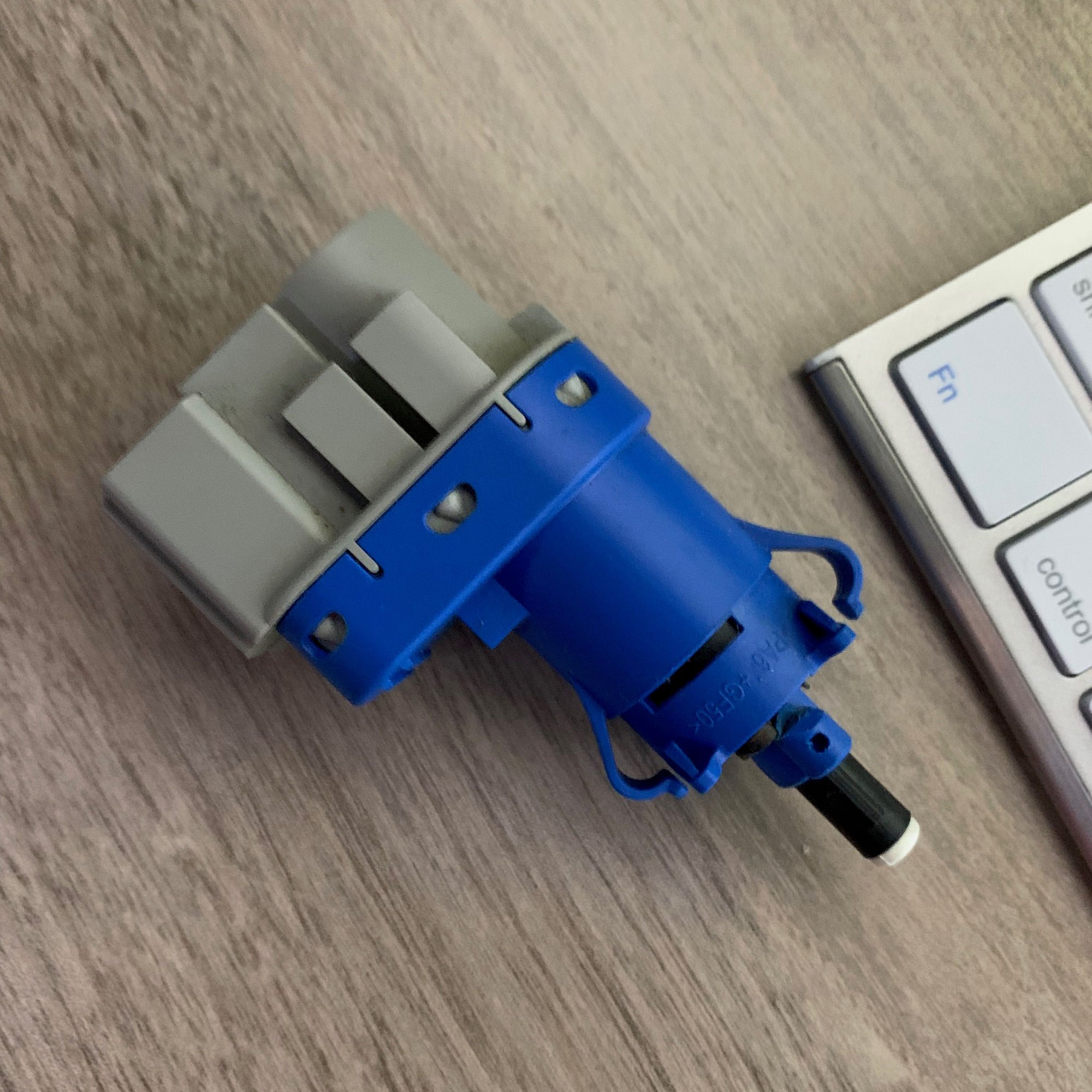

Turns out the problem was this little switch
Picked up a replacement switch at AutoZone and it's plunger was 3/16 longer than the one from the factory and the black wings on the barrel were all bent up. Brake pedal test looks good, lights up and stays off, test drive proved it was working properly now, no slowdowns and even the cruise control held just fine.
