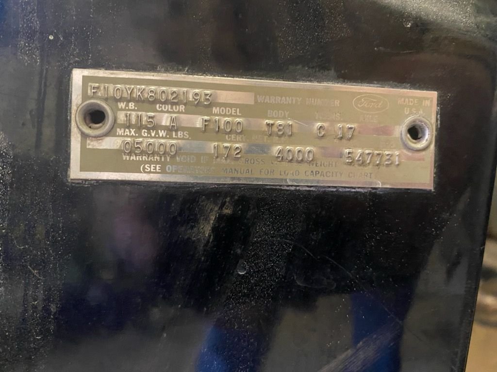

Yes please. my VIN tag is as follows: F10YK802193 115 A F100 T81 C 17
05000 172 4000 547731

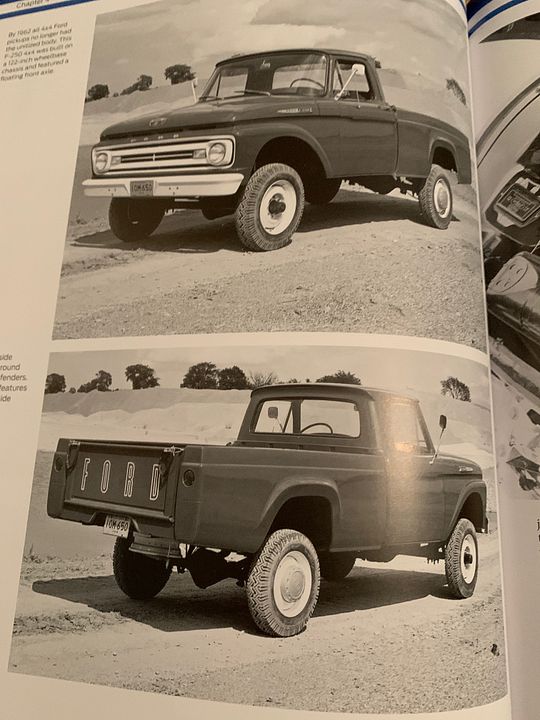

Here's about the best under hood original factory photo I've found so far. Black and white picture. Definitely a bit more gloss on these inner fenders. I think some they hit lighter than others depending on the day or who was doing the spraying, or any number of factors. I've never seen anything that holds up as well as the shine on the oil baths. And right in the thick of the heat no less.
This is a fairly low mile Ranger that used to be in Washington state, but the inner fenders are still covered with a light surface rust. Very common even in the desert.

This is the truck with the underhood picture. A 4x4 that's being driven on dirt roads so the dust and dirt makes sense. I noticed in the picture that the radiator cap has also been removed.
