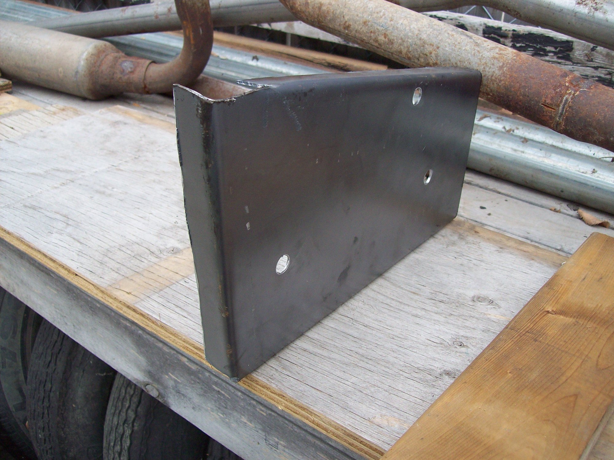

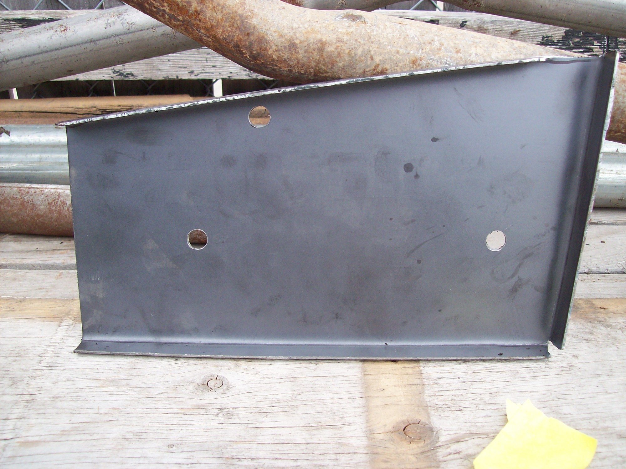

These bolts are 5"
I will sandblast inside as much as I can then epoxy. the round hole is for the box adjuster nut. I will not put it in.
If you blow this up until the bottom measures 12 5/8" and trace onto paper. Bend your right angle flanges 1" and weld in 3/8 plug welds to frame. I will use 3/16 plate to stiffen up this area, will be bullet proof. egcellent.

Replacement plate

Does it reposition the box significantly or just by the thickness of the plate?

Because the plate is on the outside of the rail it does not change the position of the box at all. If you were to add thickness to the inside rail where the box is mounted then it would.. The reason it rots in the first place is it is a enclosed boxed section with no drain hole. Salt water sits in there and causes corrosion. I will drill two 1/2 holes top and bottom in a position that can be accessed with pressure washer to keep clean, Pump lots of tranny fluid in there couple times of the year also, the oil creeps onto all surfaces and moisturizes the metal. I do this for door bottoms, rockers, wheel wells, a pillars. drip rails. any enclosed section. saves the metal forever..

The plate is challenging to get to fit just right, keep tweaking it. Once I get the holes lined up I will put another layer for the bolts to be real stiff.
