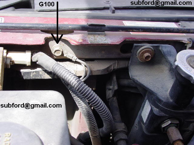

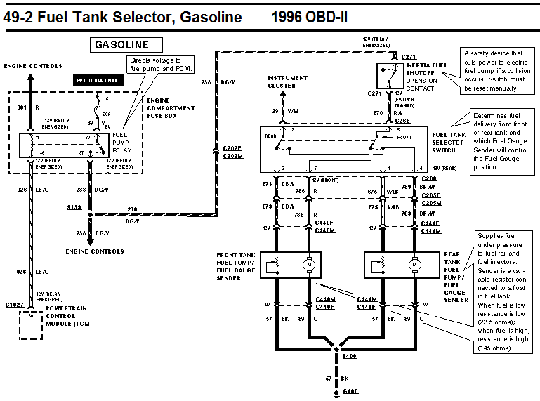

Pegging past full means an open circuit from the fuel gauge all the way to the ground point at the radiator support.
The fuel pump(s) will not run also if no ground at the radiator support.
The ground at the radiator support.
Attachment 277901
Attachment 277902

This is the ground that I replaced with a new wire and cleaned up the contact points. This is also the ground that I was originally told to check. And it did work for a while I had no problems with starting at all.
thats also a marine battery..
