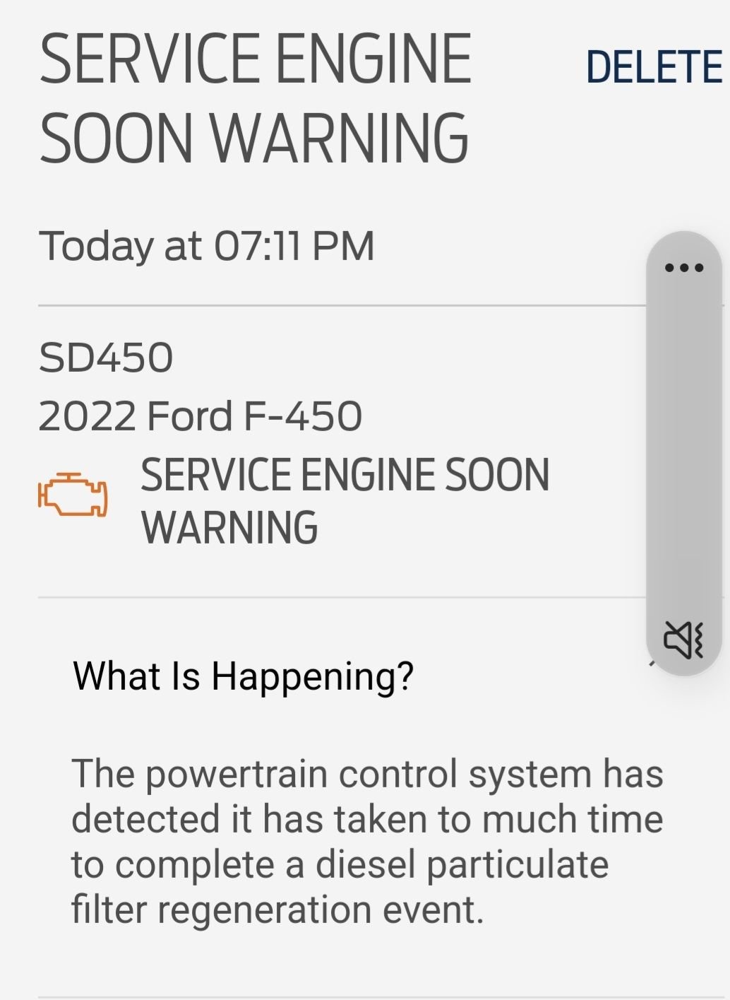

After the truck was parked Ford Pass sent me another message, back to the dealer tomorrow.
Old Sep 12, 2022 | 07:31 PM
jackfordsd350's Avatar
jackfordsd350
Joined: May 2016
Posts: 997
Likes: 262
From: Central New York
And this also
