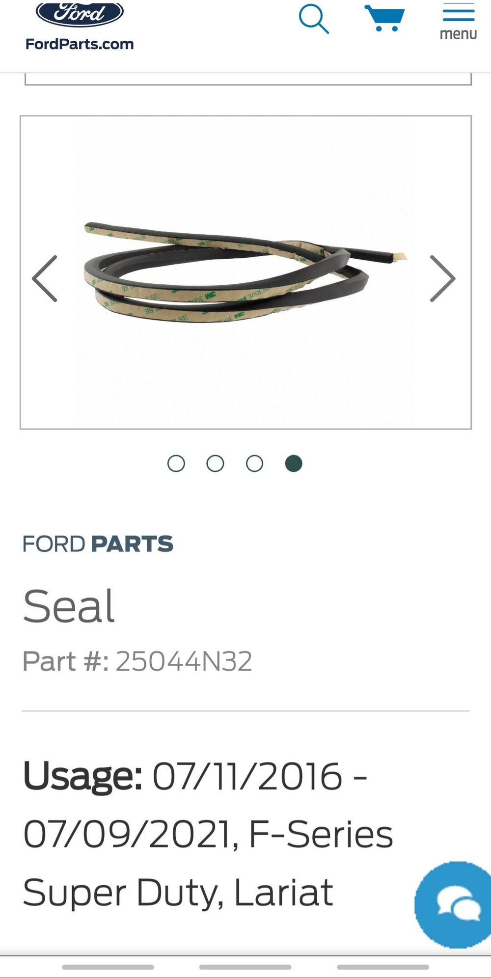

Where are you researching? It's been verified by others in posts elswhere that it is adhesive backed.
Here is the part# if interested HC3Z25044N32A, and you can see the adhesive strip in the screen shot bellow. You could probably get creative and figure out a way to set it without pulling the glass. Others have just deleted it when it started to become an eyesore and claim no ill effects.

I researched this site almost exclusively. I do notice the adhesive strip. I'm sure it is near impossible to place with the windshield in place. I just really hate the idea of another windshield pull to replace this, but it really looks like hell. Not just it sticking up like many threads mention, but actually sliced and generally boogered up a good bit. I was not even looking for it and noticed as soon as I sat in the truck.
