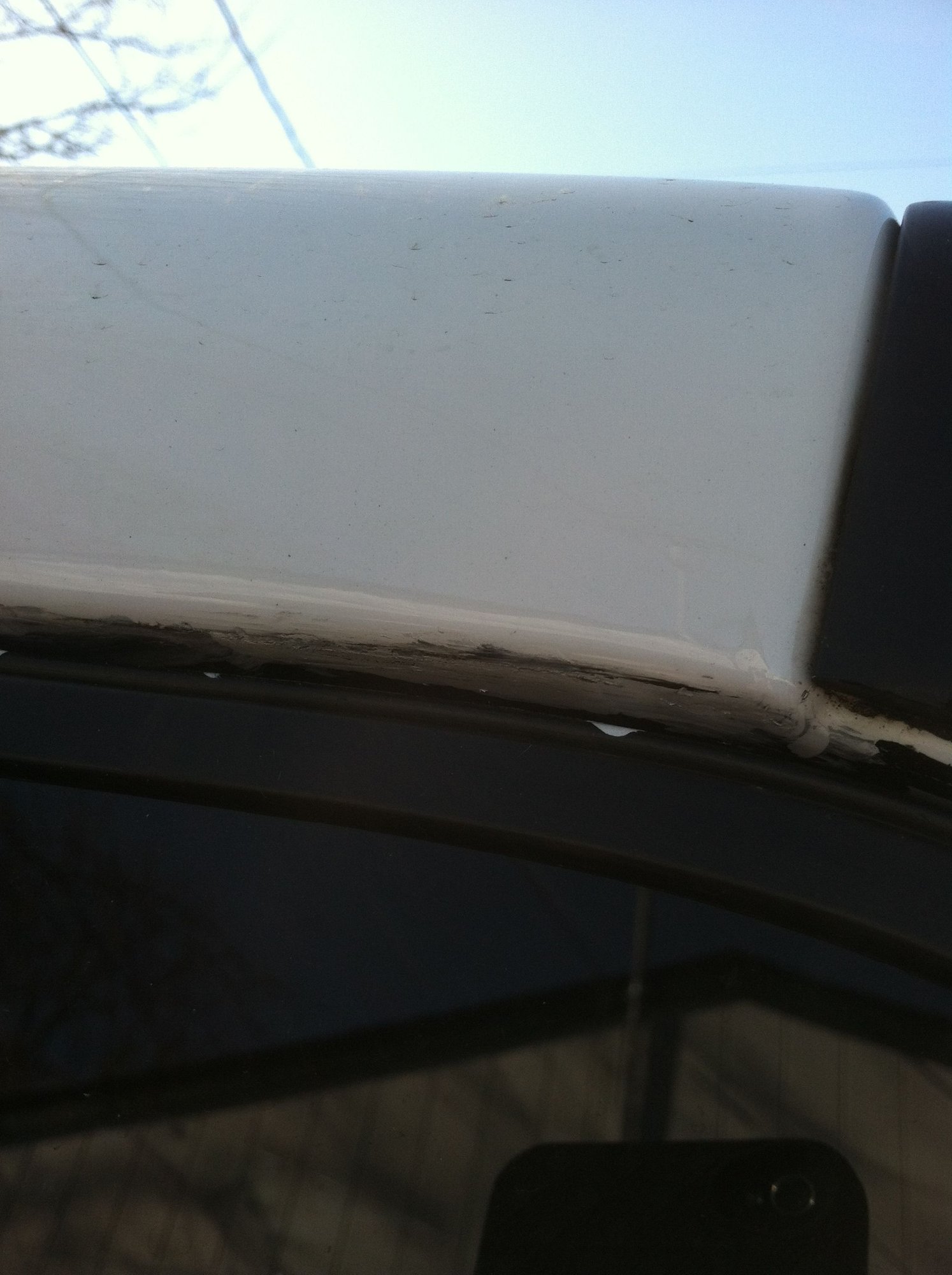

Here's what Safelite did to mine:

Jesus ATC, that's horrible. Is that the back window?
I guess it comes down to the person doing the work.
